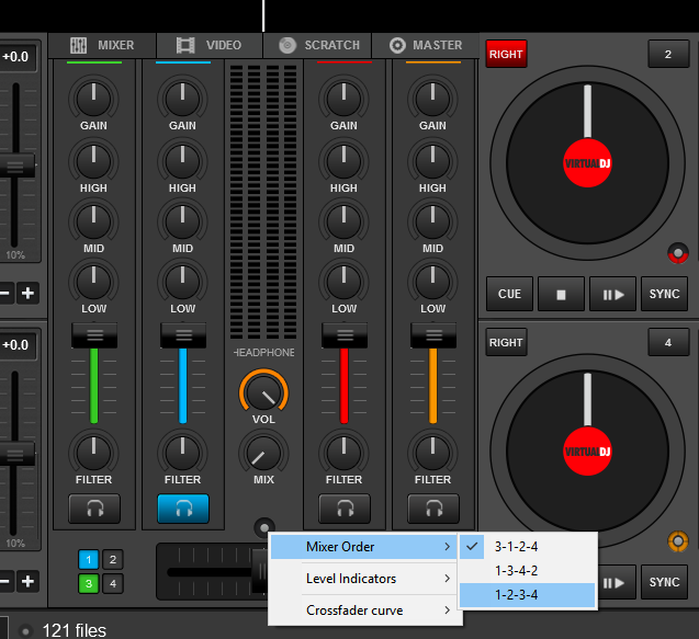

If you want 1234 mixer order then just change the mixer order from the menu button on the VirtualDj default 4 decks skin:
