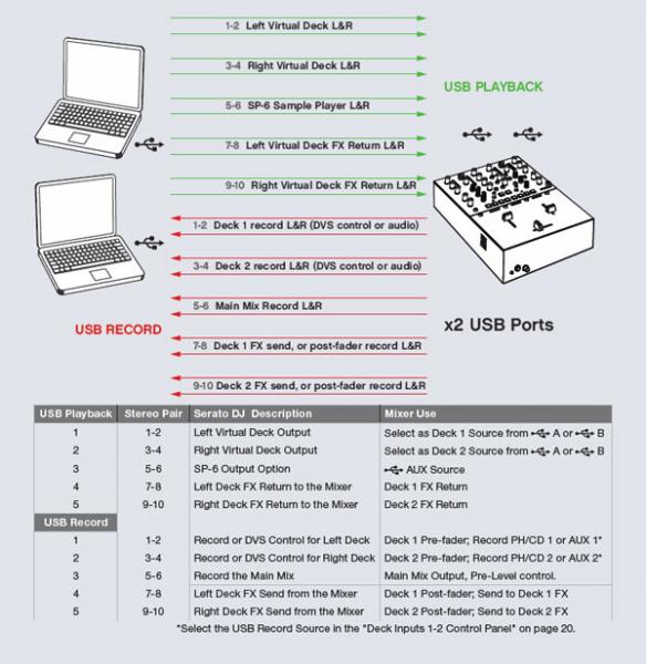

SO i was extremely happy to read that the latest build has post fader effects option.
Unfortunately it doesn't seem to work for me.
I am running a Rane TTM57Mk2 mixer which has the sound channels to route the effects back to the mixer post fader but i still can't get it to work.
In my soundcard screen i have the option to route the sampler back through these channels but not the effects.
So basically i'm not getting anything post fader.
Can anyone help here?

Yeah okay, TTM57mk2 definately supports effects return over USB. I can even choose the effects return channel in the soundcard menu, just can't choose effects as its source. Here is the channel layout for my mixer if it helps
Thanks anyway though.
Posted Thu 04 Aug 16 @ 8:40 am
Rane 62, 64, TTM57MKII and Pioneer DJM-S9 are the ones that we know for sure that they offer FX Send/Return Channels. We' ll check others too when this is implemented.
Posted Thu 04 Aug 16 @ 9:13 am
