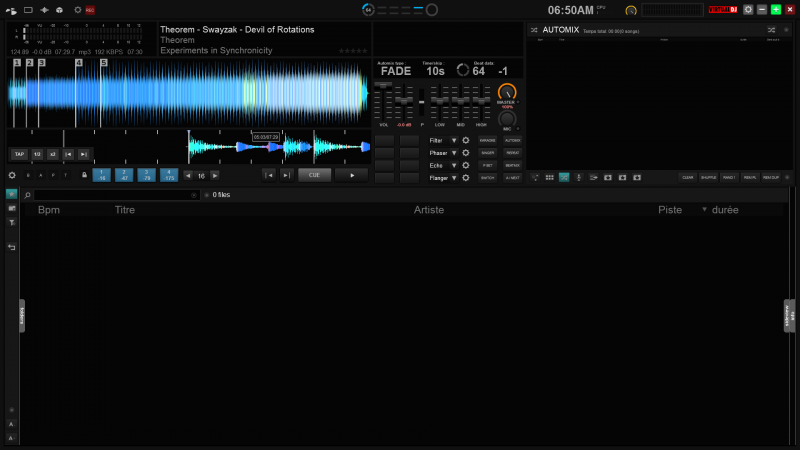

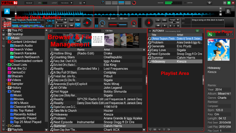

If you use Browser Zoom in VirtualDJ 8.2, you might just find that the default skin has everything you need. More about Browser Zoom can be found here.
When Automix is engaged it will feed the active deck leaving the 2nd deck free for live mixing (or previewing if you want). But there is also the preview player in the Info Panel that will preview the tracks in your headphones simply by highlighting the track and clicking on the play button in the panel.

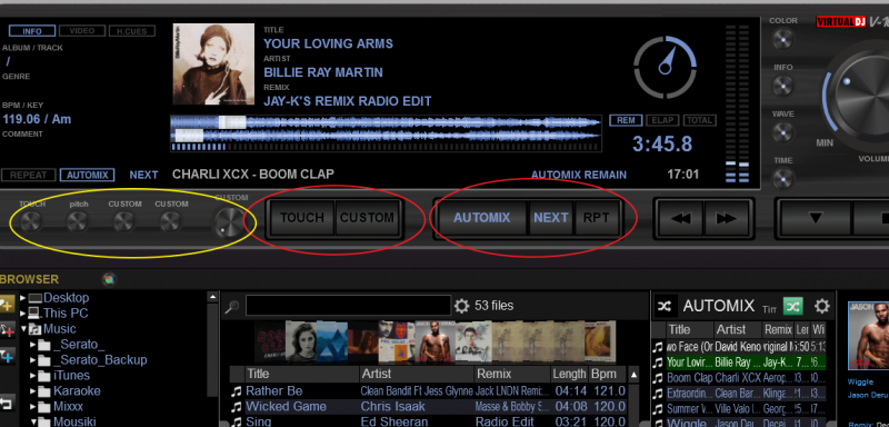

http://www.virtualdj.com/plugins/index.html?addonid=80339
might wana check out this skin maybe just what you want
Posted Fri 15 Jul 16 @ 12:57 am
Indeed, this is a Skin created for such purposes. Single deck skin with some Automix dedicated buttons and extra Custom ones to assign those to whatever you want.
The NEXT button on this skin will skip the currently playing one and will mix to the next one from the Automix List.
Most of the Automix options you get from the Options menu have vdj scripts to use in custom buttons, so at the end you ll have whatever you want
Skin has 2 main windows.. The Player is visible when you first load the skin. Use the Maximize button at the right side to set the skin to "windowed" view (or else you will get a large black/empty space at the bottom) and then grab the right-bottom edge to resize the window to a smaller size.
then click on the Database button on the right side to reveal the Browser window, which is also resizable.
Both main and Browser windows are movable and resizable as above.

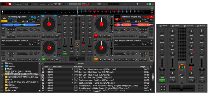

Hi! Just purchased the American Audio VSM5 & am disappointed to see there is no Virtual DJ skin for it as there was for the VSM4 ...... Any plans to create a VSM5 skin in the near future?
Posted Sun 21 Aug 16 @ 7:09 pm
is there a way to edit this skin or the settings so it only shows the mixer part
Posted Sun 28 Aug 16 @ 1:40 am
It's possible to edit all skins. You just need to have the skill to do it.
The skin SDK can be found in the wiki, and I'd recommend studying a few simple skins to learn the basics.

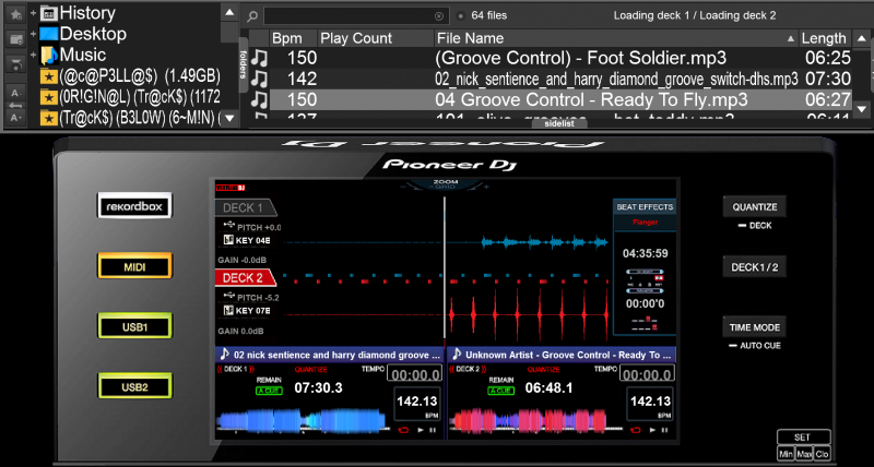

i allready have a skin for the browser and waveforms i just need a mixer skin for another tablet
a quick video of the browser skin
https://www.youtube.com/watch?v=uOnkWSL_fEE
i only have 3 usb ports on my computer and too many items that need them so by having the setup on 4 tablets connected through virtual dj remote i can get rid of my numark n4 and the need for an external sound card too and free up usb ports for my midi piano and sample pads external drive and so on
Posted Tue 30 Aug 16 @ 3:31 am

i already have the browser and waveform skin on a seperet skin/tablet
.png)
Posted Tue 30 Aug 16 @ 11:22 pm
That's not a browser - that's 3.5 lines! Plus all your left side icons are squashed together because the browser is so small.
Why waste so much screen space on displaying a "looky-likey" picture of a Pioneer display? You could use all that space for a full screen browser.
The track info should be displayed on your "deck" tablets - or your main computer, seeing as you still need one to run all those remotes.
Just doesn't make sense to me. :-/
Posted Wed 31 Aug 16 @ 7:54 am
thats used as a display and i had to load it on my laptop monitor to take a screen shot to show you it dose not load the browser the same way on a tablet watch the video link i posted before putting me down please :P
not only that do you think if i created the sklin i use for the browser that i would be asking for help from you guys with a skin for a mixer ??
hahaha !! :))
Posted Wed 31 Aug 16 @ 8:07 am
