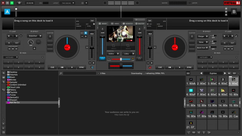

Hi all, I've downloaded 8.2 and now for some odd reason my video output is blurred/pixalated. The two deck screens show the video perfectly its only the output that is affected. This is on default skin and the same on two other skins I've tried. All was good with 8.1 running perfectly. I went back to 8.1 and all I got was all blank video screens. Downloaded and reinstalled 8.2 again and still the same blurred output. Win7

I'm running nvidia GTX280 card with all drivers up to date. Video macro set to smart, DXVA-no, video resample-high. Changing thesis has no effect on the blurry screen.
I've discovered out of curiosity if I go into BIOS at start up and disable both video cards then save and restart the problem goes away. Until the next 'normal' start up.
Posted Sun 10 Jul 16 @ 12:51 am
I forgot to mention that this happens with any video, even milkdrop is blurred. Anything that shows in the middle screen is blurred but both deck screens are perfect. This happens with and without an external screen connected.

You are talking about the middle screen, but how does the actual video output (either second screen or the video window) look like?
Posted Sun 10 Jul 16 @ 4:30 am
No plugins activated at all. Yes the middle screen. Same on monitor or video window if no monitor attached.
