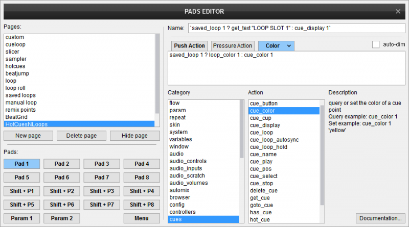

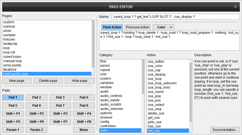

For controllers without RGB colors, the Led of the pad will be ON depending on the true/false return of the assigned action.
In case you need to explicitly control how the LED will behave, you will need to manually add query="" to the page xml.
So open the page xml you will find in the Pads folder with a Text Editor and edit the lines of the pads like the following example...
<pad1 name="..." color="....." query="loop_roll 0.5 ? blink : on">loop_roll 0.5</pad1>
If you want to modify a default page (those will not be visible in the Pads folder) you will have to open the page with the Pad Editor and change/edit something minor. Once something is changed, the pad will be exported in the Pads folder (dont forget to put back what you changed)
Keep also in mind that the query="" will also affect the Pad on the skin as well.
Alternatively, you could also add this to the Push action inside the Pad Editor (without exporting). So something like ...
loop_roll 0.5 & loop_roll 0.5 ? blink : on
should work too.
