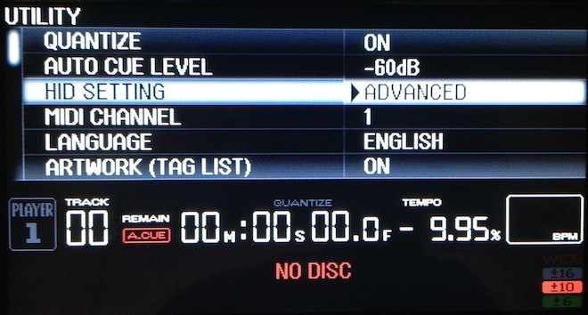

You need to run the latest firmware on your CDJ's to activate Advanced HID. In order to activate Advanced HID, go to the UTILITY settings on your CDJ by pressing and holding the MENU button (located at the upper edge of the device). Set the HID SETTING to ADVANCED as shown in the image below:
Finally exit the UTILITY settings by pressing MENU again
PhantomDeejay- Thank you for the response!
I have the CDJ's upgraded to the latest Pioneer firmware (1.25). The HID setting does not appear in the UTILITY settings on these CDJ-2000nexus units. I just confirmed that the original units that were connected to my computer at a friend's house were indeed CDJ-2000nexus and that the CDJ's displayed "HID Advanced" and asked for deck selection on the CDJ screen during setup. This is very confusing. I just want to make sure I'm getting the absolute most out of the setup between VDJ and the CDJs!

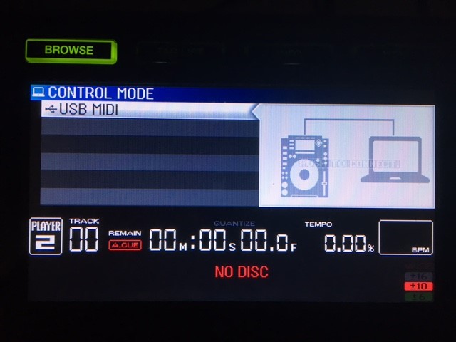

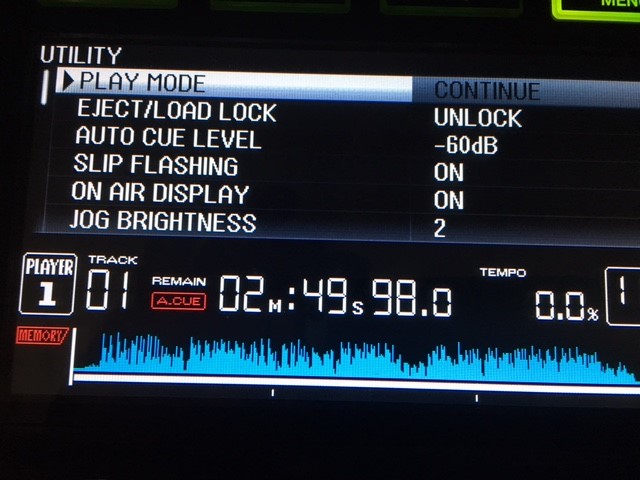

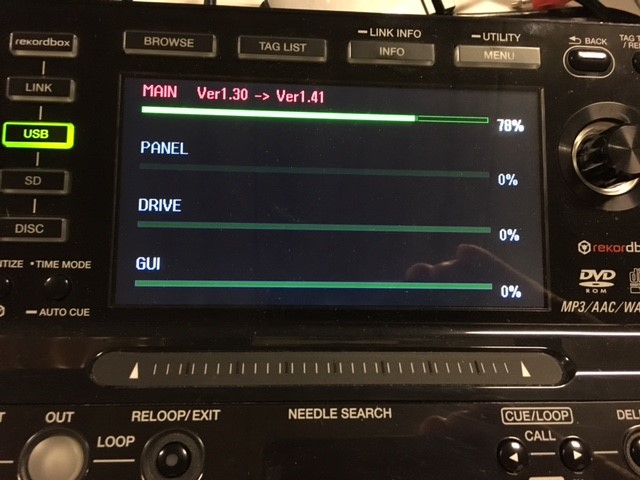

Same problem here. HID mode is simply not shown in the utilty list (see picture) and my CDJ's have the latest firmware (1.41). Now that I look at your display PhantomDeejay I also don't have Quantize or Artwork in my utility list (see screenshots). You're not using a CDJ2000NXS2 by any chance?
