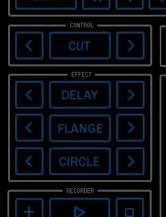

I've tried several ways, following your advice Adion, but I can't get the Beat Grid effect to work with different slots with one button...
This is my last invention:
<button action="effect_active 4 'Beat Grid' ? effect_active 4 'Beat Grid' off : effect_active 4 'Beat Grid' 7 on">
This code is inside a deck container. It's the fourth set of effects (as you can see in the screenshot), so that's why I put in the slot number 4. The 7 is to indicate the Beat Grid slot.
