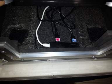

so i was messing around and checking my usb cables. and when i went to wiggle some of them i found out the (white one) which is going up to my laptop, to be loose & makes that sound windows makes when you plug & unplug something into the usb ports. the 2 black cables are going to the SC3900's. not sure if this is the problem with my sc3900 randomly stopping. as when it does i just hit the play button and the music continues to play on. my thinking is if it were a bad usb cable wouldn't the music just stop period ? and or it would effect both players and not just one right ?
anyhoo my Question for Owners of the sc3900's do ya keep yours plugged into a usb powered hub or connect them directly to you laptop ?
thanx for any advice/help

I plug both my 3900's directly into 2 of my laptop ports. Everything else I run off of a USB hub into the third port on my laptop.
Posted Wed 04 Nov 15 @ 6:56 pm

thanx for the quick reply :-) im thinking about saving my $ and just them in direct. but some had said in the past they (sc3900's) pull to much power from the usb post & that why to use a powered hub ? since day one about 3 years ago when i 1st got them. thay have always been plugged into an an powered usb hub.....
