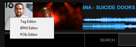

Wondering how to remove the menu from the album art that pops up if someone clicks on it. I don't want a DJ to be able to enter the Tag menu from clicking on the album art in this skin. Is it possible? Thanks in advance.
Posted Sun 22 Sep 19 @ 8:16 pm
