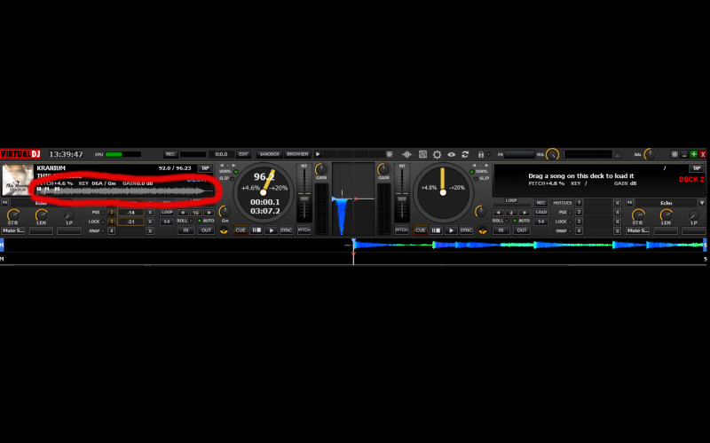

Hi. When I load a track in VDJ 8 the waveform is grey. Can someone please tell me how to change the waveform colour in VDJ 8?

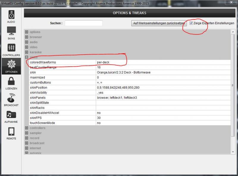

Go to Config - Options and search for "coloredWaveForms".

Thanks for the reply but I have already tried that. I'm trying to change the colour of the 'wave' that is loaded when I import a track. I've tried to upload an image to explain what I mean but it didn't work. The skin I'm using is Orange Juice (2 deck bottom wave).

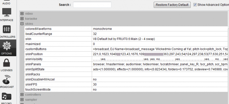

check advanced options then have a look here
also it could be the skin you are using if you have changed in options and it doesn't work

Perhaps skinDisableHWAccel is set to yes?

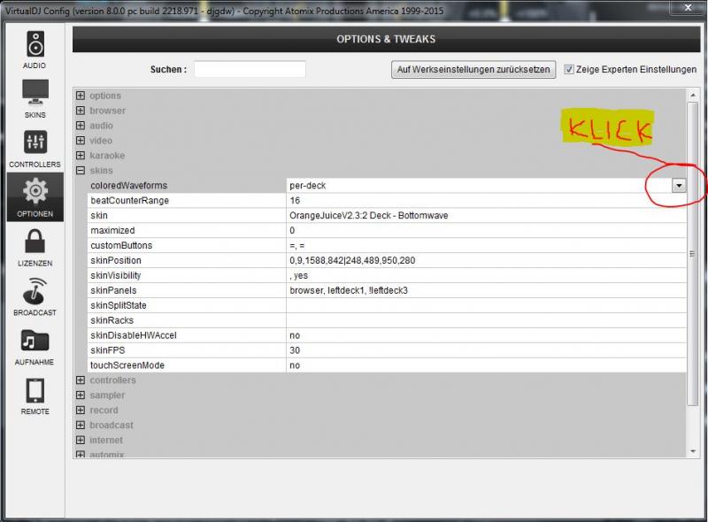

Have a Look on my Picture

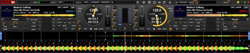

Posted Wed 29 Apr 15 @ 7:17 am

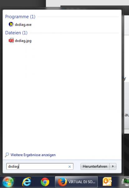

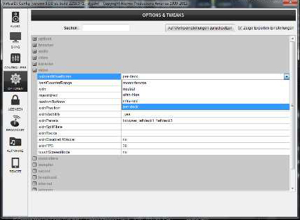

Next Step
Posted Wed 29 Apr 15 @ 7:25 am
Next Step
Posted Wed 29 Apr 15 @ 7:32 am

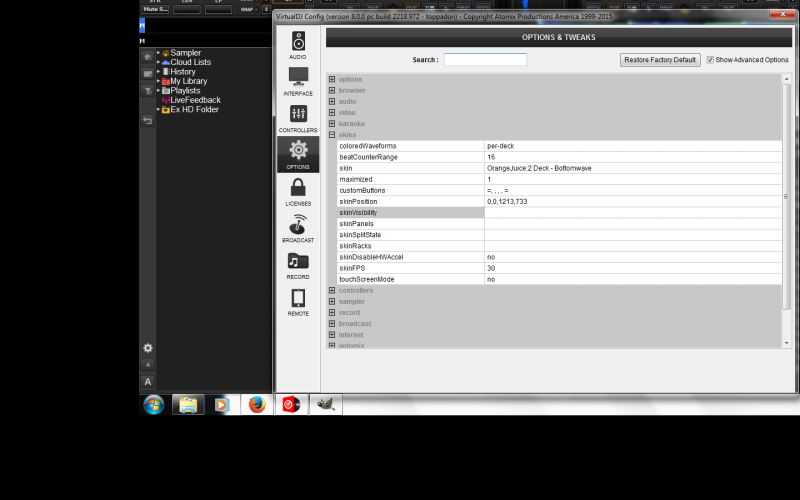

Thanks for the replies but this does not change the colours. I have uploaded a image to show what I'm trying to change.
Here are my settings
Posted Wed 29 Apr 15 @ 8:03 am

hey...great skin :-))

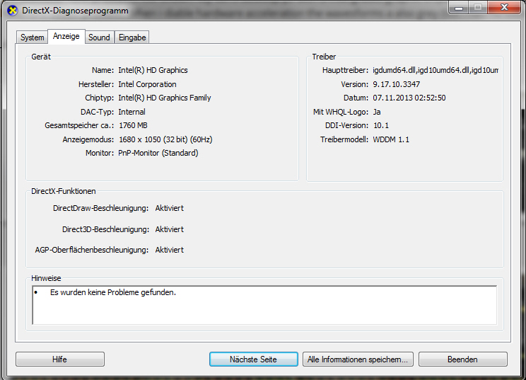

some intergrated gfx seems to have problems like shown. My 0815 desktop-pc with a intergrated graphic chipset had also problems with Waveforms and grids. I think its a hardware based problem. When i disable hardware acceleration, the wavesforms are also grey (but i had no visible ScratchWaves).
with no other solution, it would be interesting, what happens, if you try an external grapic card and disable the internal one.
HW acc off
HW acc on
what are your DX Settings?
HW acc off
HW acc on

My machine is a similar story, no coloured pos waves & 4 deck default waves are so dark they're near invisible, I think for tech as old as mine is there probably isn't a solution.

Thanks for the replies and I think you guys have found out what the problem is! I'm using VDJ 8 on my desktop and it only has an on-board graphics card with 256mb in memory. I believe that this memory is also shared with my system memory. So I now think that if I install a proper graphics card onto my system then the 'song position' colour will change.
