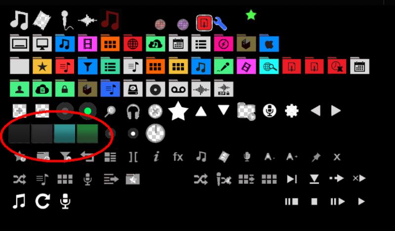

No, I mean these ones (the square buttons).
Posted Thu 26 Feb 15 @ 5:56 am
Buttonbackground - Browserbuttons are here inside the sysicons:
A6 to D6 (Fruit skin)
Posted Thu 26 Feb 15 @ 6:18 am
Yes I know where they are. I just need to know the code to use them. :-)
So it's sysicon="buttonbackground" or sysicon="A6" or what?
Posted Thu 26 Feb 15 @ 6:20 am
If there is a (browserbutton-) icon inside sysicons, they will be automaticly used. On clear/empty space inside sysicon, default is used. I just had the same question an tested it with 2 png. one with those icons and one with transparent pix instead of Browserbuttons

Althought you may call those pics directly by using their coordinates instead of a name. Let's make a sys class :)

you need no code. Just paint some gfx at the browserbutton place A6-D6. VDJ will use that and overwrite the default.
A6 is normal background and B6 mouse over

took a look inside the VDJ Code ;-)
all words in sysicon context are:
sysicon dx dy width height
downx downy clipmask mask over down up selected overselected downselected disabled action leftclick rightclick middleclick dblclick actiononover textdown textover textselected
sampler_bank context_menu _options 'popup' play_button stop_button sampler_mode add_favoritefolder add_virtualfolder add_filterfolder goto_last_folder grid_view view_options 'showmusic' view_options 'showvideo' view_options 'showkaraoke' show_splitpanel 'info' show_splitpanel 'sideview' show_splitpanel 'effects' font_size - font_size 0 font_size + sideview 'automix' sideview 'sidelist' sideview 'sampler' sideview 'karaoke' sideview 'clone' sideview " sampler_bank -1 sampler_mode -1 sampler_bank +1 sampler_mode +1 sampler_bank ' sideview_triggerpad karaoke effect_dock_gui effect_show_gui effect_active effect_button search
try to call icon with coordinates
