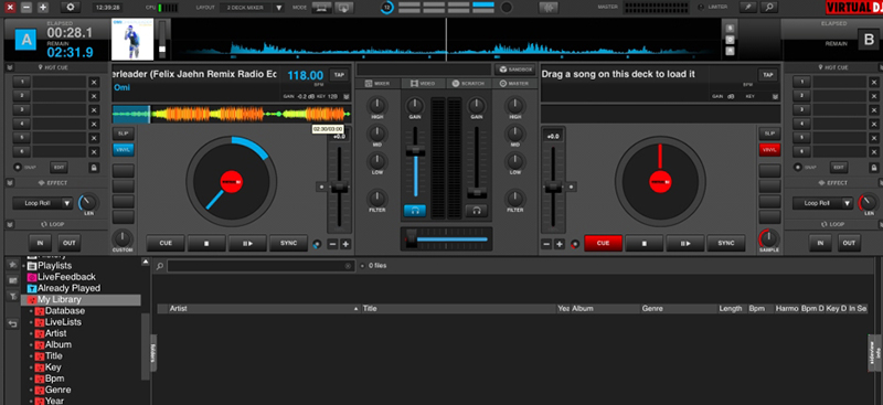

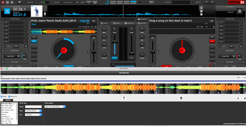

If I open up the POI editor then it's on top of VDJ like this:
If I take off the POI editor's focus then I don't see the (full) POI editor anymore, or I have to resize the VDJ window so small that I don't see that anymore in it's full size:
So what I want is to assign a keyboard shortcut for play/pause in the POI editor, so I can use that with full VDJ window in the background and the POI editor on top of it.
In that case you can use the POI editor's waveform by double click etc. and that won't work at all when you focus on the VDJ window because then you just use your standard VDJ deck instead of the POI's waveform.
