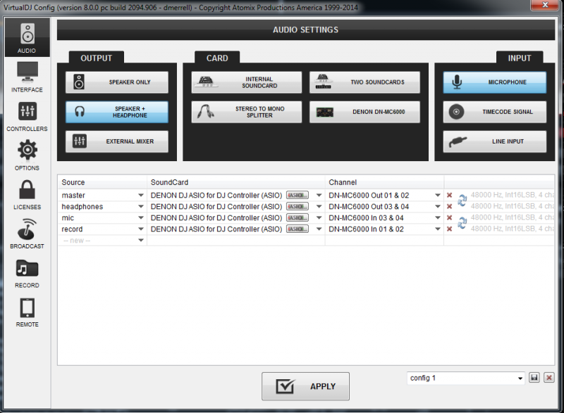

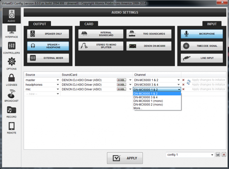

For a few weeks now been trying to get the Microphone on the Denon MC 6000 mk1 to work with Virtual DJ 8. 95% of my searches showed VDJ 7 and record loopback the others showed MK2. Decided to take a chance and download the Denon ASIO drivers for the MK2. Yes I have a MK1, the MK1 drivers did not have a "in" option on the Channel section for the Mic.
Picture of VDJ 8 Denon MC-6000 with Denon ASIO drivers v2.22 from Denon
So looking at the configuration document for the Denon MC-6000 MK2 I noticed it did have the option for "in" see image.
So far in my testing everything is working great using the Denon ASIO drivers from the MK2 with my MK1 in VDJ8.

Man, you made my day ... It works great .. Thanks .. Best regards Thorsten
