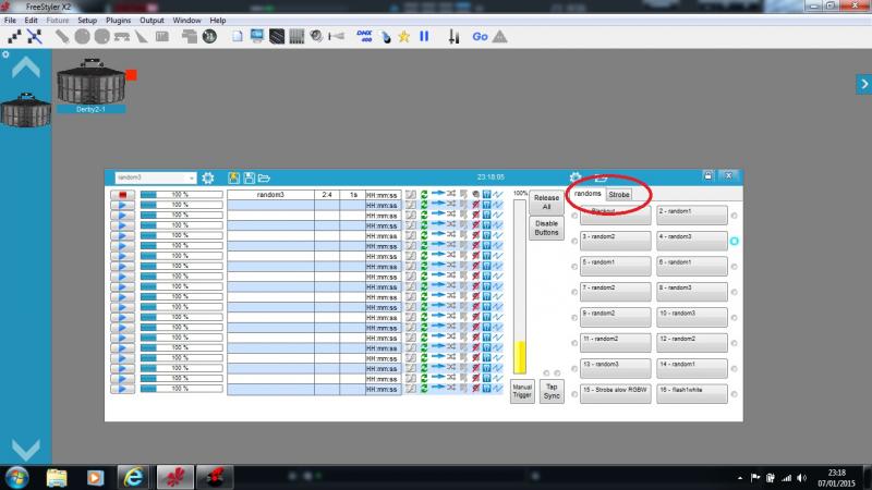

okies I am not sure if anyone can answer this question, on freestyler you have cue list buttons and can have 16 on the first page and as far as I am aware its FS:272,1 - FS:287,1 to activate them thru virt dj
Now this my main question is there a command that allows me to use another page without having to switch pages manually. If I needed to use a different page IE Strobes (as in the pic) as I would like more effects than I can currently use. using FS:272,1 will always activate the cue list button on which page is currently open.
otherwise I could have 6 tabs with 16 buttons on each which gives a total of 96 buttons

okies I have sorted this and for good reference for you guys it was quite simple kinda
to get different pages on FS you use 2 commands in a single cue point
EG. FS:267,1 FS:272,1
this would switch it to tab 2 or in my case Strobes and select the first cue. the first tab is always 1 cue command?
266 cue list tab 1
267 cue list tab 2
268 cue list tab 3
269 cue list tab 4
270 cue list tab 5
271 cue list tab 6
hope this helps as now you got a total of 96 effects
266 cue list tab 1
267 cue list tab 2
268 cue list tab 3
269 cue list tab 4
270 cue list tab 5
271 cue list tab 6
