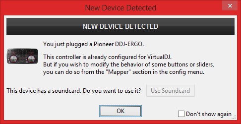

Yesterday I have started to use my new console DDJ-ERGO-V (previous one was Hercules RMX). Latest firmware and drivers updates done and the console connected to pc via USB 2.0. (and not powered USB Hub as indicated in the manual)
While using the console encountered with following problem:
1- VDJ 1872.704 detected the device.

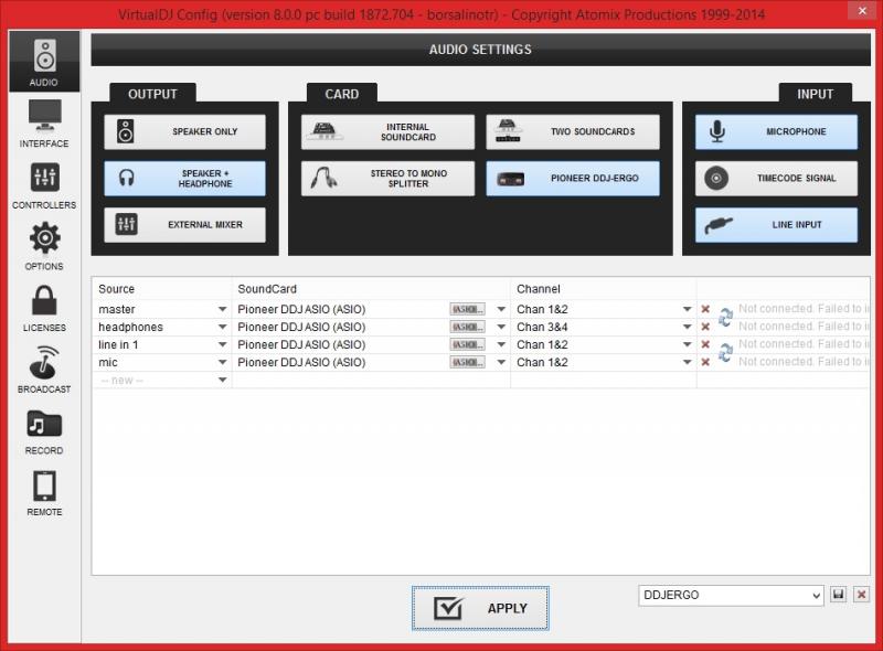

2- Audio Settings windows appears:

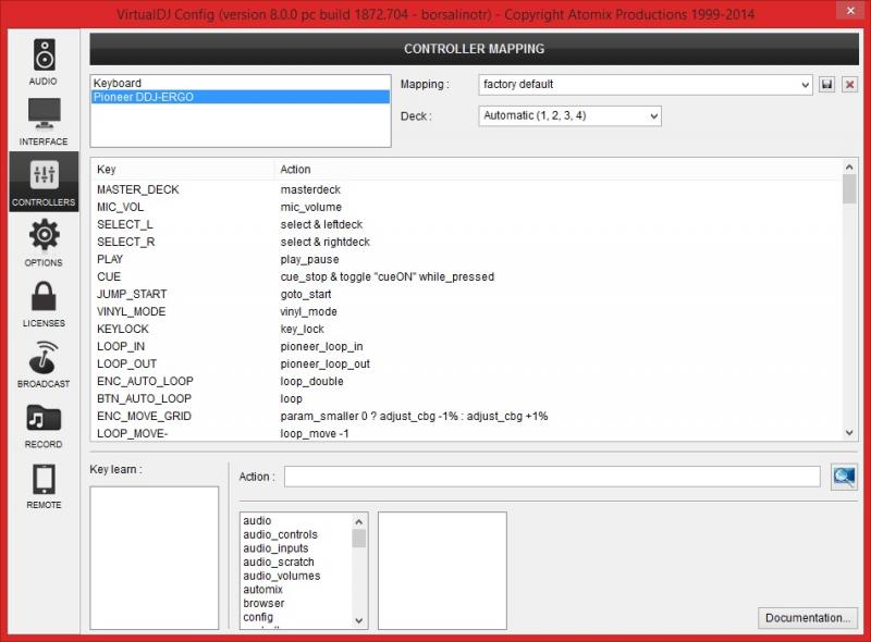

3- On controller mapping DDJ-ERGO choosen.

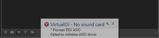

4- After click on "Apply" in Audio Settings, last column shows "Not connected. Failed... warning and a second small windows opens with an error msg too.
At this stage although VDJ 8 seems functioning there is no sound in headphones.

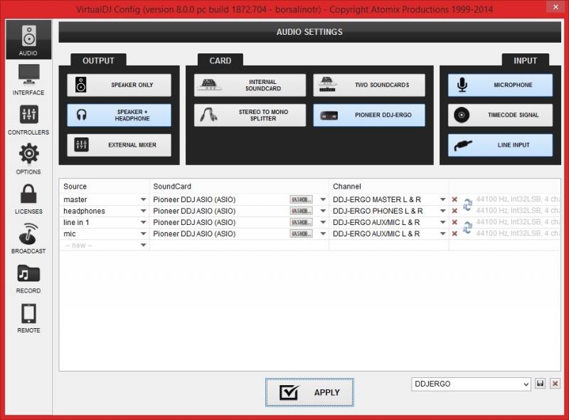

5- While on Controller Mapping Windows, I have turned off DDJ-ERGO and turned ON again. After DDJ-ERGO reappears and factory default choosen Audio Settings windows become correct and after click on Apply the controller functioning correctly with sound on Headphones.

Mine runs very well on VDJ 8 latest versions also. Sometimes I receive "sound card not detected" error messages but when ERGO-V closed and reopened VDJ 8 detects immediately drivers and works perfectly.

I install the Win 8.1 pro 64 bit. And vdj 8 says the same error. who can help me please?
If the Ergo is selected as the default sound card of your OS, try to select a different sound card as default. Windows sometimes tend to change the default audio card to the connected one, which could lead to the reported issue.
