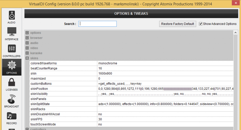

The browser options button should give 4 options, but I only get 3 (show only; root elements; database) The option : Display list as is not there I have reset to factory options and am using the 4 deck view. I have reinstalled but it is still not on the button.
in options, tick advanced and search for touchScreenMode. set it to NO
I did that and it didn't work. It was on no and I set it to yes and back to no and restarted and checked it was still no and I still did not have the display list as option on the button. I think I need to make a change in the registry. Any ideas?? I can't use it in grid mode.

Hi all, in the version of Virtual DJ 8.0.0 pc build 1949,795 the problem persists, in the list is still missing an option (which should appear four not three) "Only show, Root Elements and Database" even lack "Display List as "I'm using the mouse mode and as you can see in the picture options that should be in the configuration are well marked, any solution found? thank you in advance for any possible help, thanks.
http://i58.tinypic.com/fucoer.jpg
PD: Sorry for my English skills, I´m using Google Translator hahaha.
