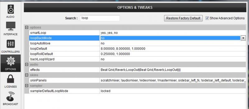

Could this be the setting that you need to check ?
Posted Thu 26 Jun 14 @ 10:44 pm
Hmmmm...is that a new setting? Cuz I've never noticed it before. It fixed the issue (it was on smart) but I have never noticed that setting before. Thanks Freppa.
Posted Thu 26 Jun 14 @ 10:49 pm
In the loop options, do you have "back" enabled?
Posted Thu 26 Jun 14 @ 10:50 pm
Thank you Freppa, that solved it ;) .
There is a popup window asking which behaviour you prefere when yu try to set your first loop. Maybe yu did not read it completely and just clicked ok ;-)
Posted Fri 27 Jun 14 @ 1:21 am

@gkon116 you want to set backLoopWizard to no
