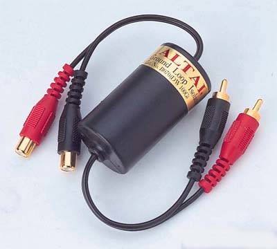

Try using one that looks like this:
You should be able to find this item by searching Amazon or eBay for Ground Loop Isolator
NOTE: If you run an external mixer setup, then you will need one of these for each output from your DJ sound card or DJ controller. If you run XLR outputs to an amp, then you will need a ground loop isolator that has XLR inputs and outputs.
