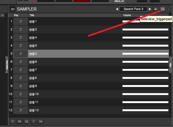

How can we arrange the samples on the sample pads?
I have already suggested the build of a little button line under every sample pad to use it as a sample editor shortcut (on click) or free move the sample on the sample pads (on clickhold).
Also how can i sort the Sample Banks?
I wish there was a way to arrange them so i choose which sample bank comes next on pressing the (<) and (>) buttons.
It's a critical thing for us, because we need some sample banks next to each other so we don't loose time browsing them...
Posted Fri 20 Feb 15 @ 12:36 pm
          You can re-sort samples in the list view, as for bank order, I'm not sure where that is kept.
    Posted Fri 20 Feb 15 @ 12:57 pm
          I dont't think there's such a view in the default skin... I have found a list view for the sampler in another skin but i can't trust any other skin except the original one because of problems...
    Posted Fri 20 Feb 15 @ 1:20 pm
          No sampler list view is on the default skin, it's part of the browser code so it's on every skin, just drag and drop.
       Posted Fri 20 Feb 15 @ 1:36 pm
          You're right!!! Now the only problem that i have is how to arrange or sort the Sample banks in the order i want...
    Posted Fri 20 Feb 15 @ 1:51 pm
