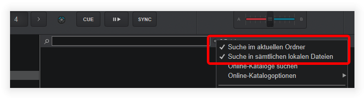

I need to get search results from a current folder and its sub folders only.
I organized my songs by genre, and within that genre folder I have a few sub folders with dedicated songs therein.
Currently, when I search I only have the option to search the current folder or the whole drive:
Live on stage, I don't have the time to disambiguate songs with similar names from different folders. I must be able to type a single word and get matching files from the current folder, including its subfolders, only.
@brille1 use a quick filter
in fact just recurse the folder.
