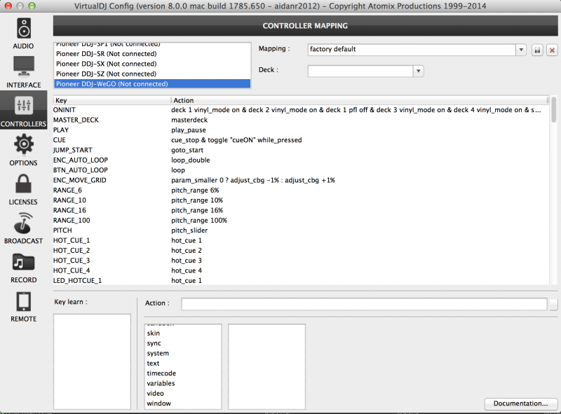

It seems as if I have a pretty major issue with the new VDJ8 software. When I connect my DDJ-WeGO, it reads it as a DDJ-SR, therefore there are buttons that are not read when pressed. I even click show all devices compatible with Virtual DJ and it tells me that a DDJ-WeGO is not connected...? What can I do to either create a custom mapping or to get native support for the WeGO?

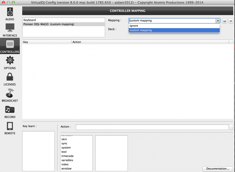

It has now created the possibility of a custom mapping but no signs of a default native mapping. Virtual DJ 8 still says that a WeGO isn't connected when I click on the show all compatible devices button!?

So in the controller list, it says that there is a DDJ-WeGO connected. However, there is no mapping for the controller when i select it. It just gives me the opportunity to create a custom map. Also when i click show all controllers compatible with virtual dj, the wego still states that it is not connected for native mapping!

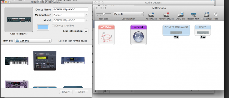

Could you please see how the unit is detected in Audio Midi Setup ?
from Applications->Utilities->Audio Midi Setup, choose from the top menu Window->Show MIDI Window and post a screenshot here that shows the name that the unit has.

It works fine with version 7! And it is recognised as a DDJ-WeGO

Here is my problem!
Posted Tue 20 May 14 @ 1:34 pm
okay so now, the ddj-wego is recognised and for a few seconds, it has the native support. When I exist this controller menu, the mapping disappears and the controller still does not function.
Posted Tue 20 May 14 @ 1:44 pm
Yes, apparently the device has not been detected properly for some reason. I ve reported this to the Team, to double-check if there is something wrong on our side, even though the WeGo works fine here on 10.9, however in the meantime...can you try to use a different USB cable and a different USB port ?
