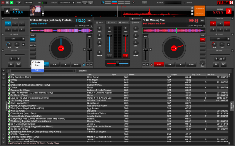

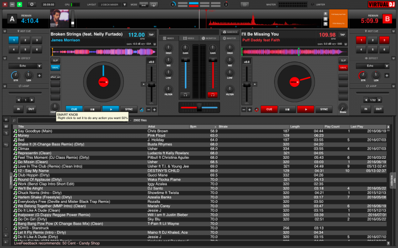

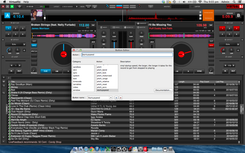

Try this.
1. Right click on the Custom Knob.
2. Select 'Edit'
3. Type 'startupspeed' in the button editor window.
4. Go back to your custom knob and make sure it is turned all the way down.
This should resolve your issue I think.

djsonance that took care of it -- Thank you soooooooooooooooooo verrrrrrrrrrrrrrrrrrrrry MUCH!!!!
