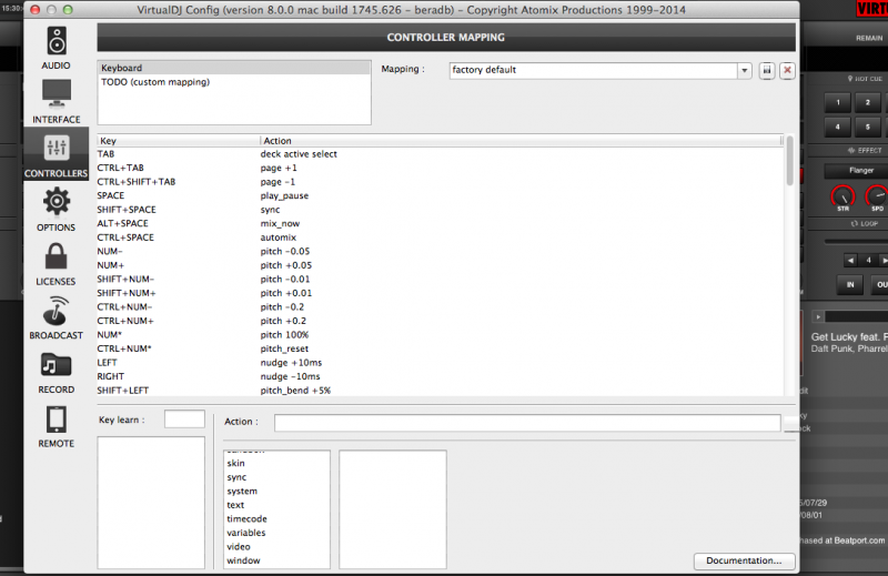

I've looked to select it on that controllers page, but I'm not really sure.
This is what I see
This is what I see
Posted Sun 11 May 14 @ 2:32 pm
I am having the exact same issue, except with a Hercules RMX controller. I've tried removing the mapping file and that did not solve anything. Also, I did not delete V7 before installing. Controller is recognized for sound but not for any type of control.
Posted Sun 11 May 14 @ 2:58 pm
