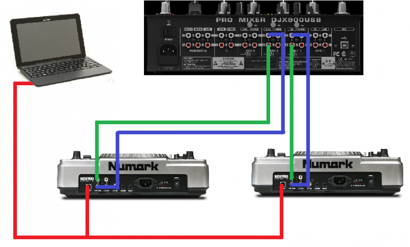

i have plugged the NDX900's in to my computer and have control with them on VDJ.. however i have no signal going into my mixer and cant mix the songs playing on vdj through the cdjs with the mixer?

You'll need to configure the sound settings in VDJ to use the NDXs as audio outputs.
Set VDJ to "external mixer" and send each VDJ deck output to a separate NDX (left deck to left NDX, right deck to right NDX).

still on the issue of splitting sound using the NDX 900s. With my decks only one of the decks produces sound that goes to the mixer (they alternate at every boot but they never have i had both decks carrying their own sound. . But the right av jack carries sound for one deck and the left av jack carries sound for the other deck so i can still mix using an external mixer. However, the other deck still controls music. My question is, how do i get each deck to to carry its own sound signal from the laptop?

to further explain, using the images provided above. from one cd deck, the green cable carries music on my left deck and the blue cable carries music on the other decks
