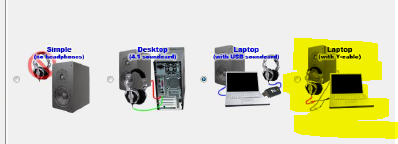

While using just the Home Free you only can connect the Y-cable with the MacAir Headphone output.
Connect the Y-cable with your speakers AND the Headphones.
Switch inside Home Free soundcard config to: Laptop - Split signal with a Y-cable
Thats it :-)
Thats it :-)

So it looks like your Config is ok and as suggested by Groovin, you need to go and get hold of a Y L R splitter cable as opposed to one which is intended to provide two stereo signals.
