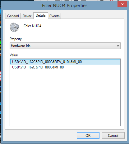

Ok here is my Ecler

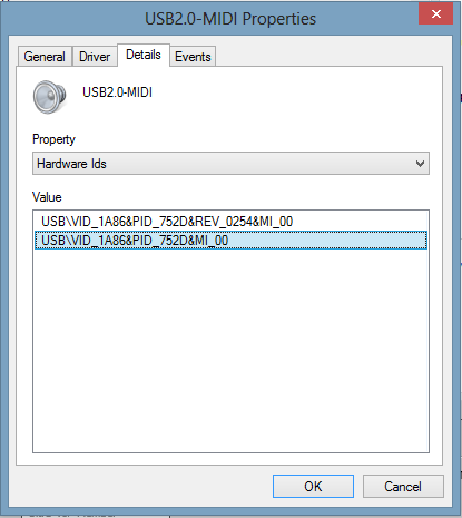

and Here is the Hosa USB to MIDI
Also hitting send with the MIDITRACE tool NO numbers show, but when I move a control the numbers show up.
EDIT
Ok I got it to work on the PC side. Since it didn't return a number I just used the drivername and now I can have both mixers hooked up and both simple midi wrapper and the Ecler show up as 2 different things which is how they should.
Thanks for the info and time Bob!!

Ok I understand the device XML (I think, lol) but how do I setup a mapping file?? I don't really understand the header.

The definition for the Ecel (name it e.g. Ecler Nuo4.xml and put it in the Devices folder), should look like...
<?xml version="1.0" encoding="UTF-8"?>
<device name="ECLER_NUO4" author="Bob" type="MIDI" vid="0x162C" pid="0x0003" drivername="Ecler NUO4" decks="2">
</device>
A mapping.xml file (e.g. Ecler NUO4 mapping.xml) needs to be present (even if it has just one line) in the Mappers folder and should look like...
<mapper device="ECLER_NUO4" author="Bob" description="Ecler NUO4" version="740" date="11/07/2009" >
<map value="CROSSFADER" action="crossfader" />
</mapper>
About the DJM...i am not sure if the HOSA USB to MIDI can be used. If the DJM is not connected, does it still show up in the Device Manager ?

No it (Hosa usb to midi cable) disappears from the device manger once I unplug the usb cable for my laptop.
Posted Sun 23 Mar 14 @ 7:09 pm
Well, you could use the vid/pid of the HOSA connector to build a custom definition for the DJM, following the same procedure as the Ecler unit.
However, the MIDI identifiers of the unit will depend on that specific connector.
If for the DJM800, the HOSA USB to MIDI is the only way to get the unit working as MIDI with VirtualDJ, then others could use the same files as well.

Ok I now have it working for the DJM800 and Ill upload the correct files for the Ecler NUO4 tomorrow night. This has been a great way to learn even though Bob gave me most of the answers, lol!!
So to recap, Im not actually getting the midi from the Pioneer 800 it coming from the Hosa USB to MIDI cable which does have a VID, PID and a driver. So in theory if someone has THE EXACT SAME CABLE they could just use my files and they'll be good to go. Ill have another Hosa cable coming in the next day or 2 so I can test it out and see if were right. If the other cable works with these files then Ill upload them to the controller section with explicit instructions and a link to the cable they need so they can be on there way.
The only things that will be mapped are the crossfader (mapped as video_crossfader) and the channel faders or upfaders (mapped as deck 1/2 video_level). I don't see any reason to map anything else as it is an external mixer with its own effects section.
