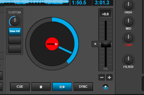

They do work - I've just tested all three
You shouldn't be in doubt when you test it, because they light up the label in red, as seen below:
A guess: Do you maybe have a space or a new-line character in the end of your script?
That often happens when doing copy-paste, and it messes things up
