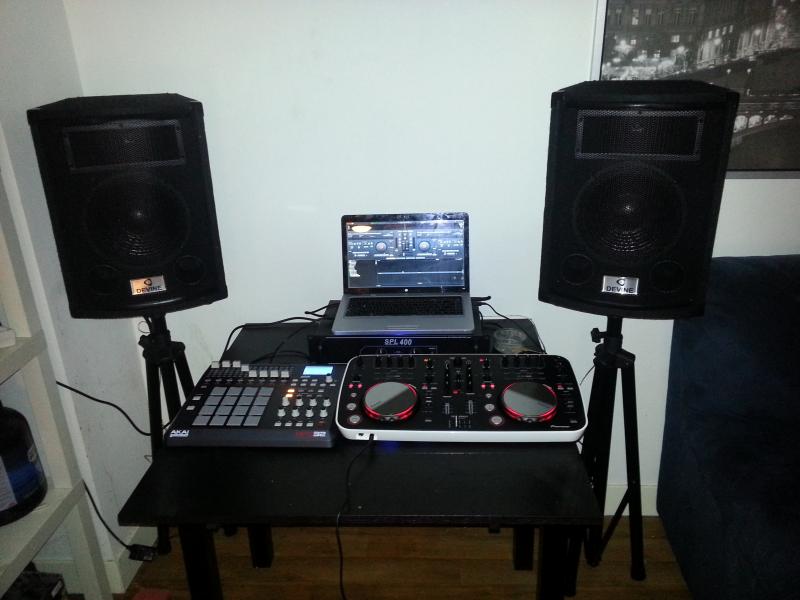

I just bought my DDJ ergo with Virtual DJ and finished the complete installations (Driver, firmware upgrade.....)
When i wanted to start playing around with the ergo the external speakers don't response at all.
My headphones/cue that are connected does work so this is a little bit strange.

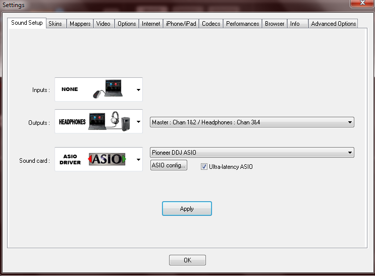

My audio setup configurations are like this:
I added the Virtual DJ pro 20 day-trail today.
My DDJ Ergo is connected with the master 2 output.
The master volume is on.
I hope you guys can help me so i can play my music with the external speakers.

The external speakers are working when i connect them directly to my laptop instead of the ergo so there is no problem with the cables or the speakers.

If you revert the output order and have .. Master 3,4/Headphones 1,2, do you get the master output i your headphones ?

I tried the TRS output and the problem is fixed now!
Still wondering why the master output 2 doesn't work.
