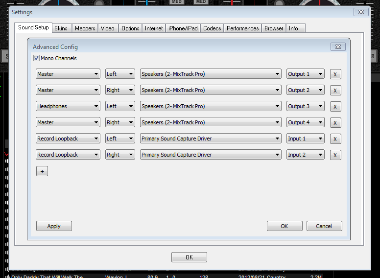

I think you can do it with advanced audio settings... I'll play with it in a few.
Posted Wed 22 Aug 12 @ 8:57 pm
That was it.
Posted Wed 22 Aug 12 @ 9:02 pm
