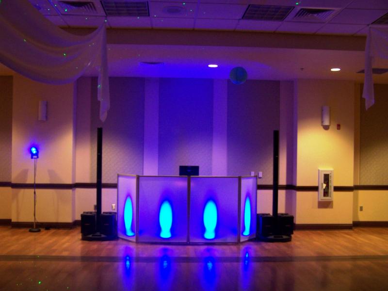

Here is a Picture of our setup. This was made by Steve Lynch. He is awesome making facades and photobooths. Its made from aluminum and corrugated Plastice. Very sturdy and our cover to carry it in was from Tuki Covers.

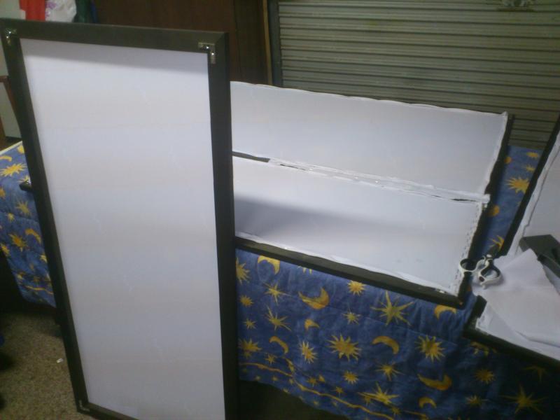

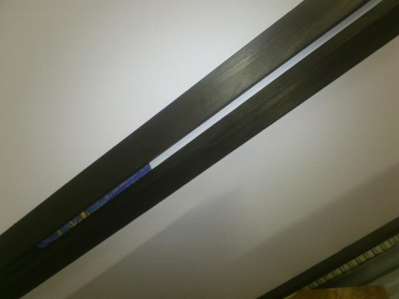

Here is the one I built
tayla wrote :
@pseft, you need to put those strengthening brackets on the inside and give them a lick of black paint, I'd also suggest you get 5mm x 20mm edging strip and colour it black then use it to hide where you stapled the material all around the frame. Will make for a much better finish when people come onto your side of the frame. Don't try to paint the material side as it will only "bleed" over.
i have them strengthening brackets on both ends for extra strength... i have the other panel stained but will b painting them all black.
i will be buying some edging strip, coz it does look kind of ugly looking at it lol.
