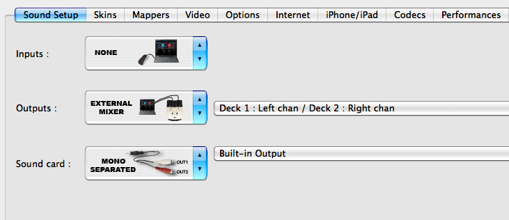

BAdaDJ wrote :
Sound setup: Headphones and Mono separated.
First do your VDJ soundcard setup and configuration like the picture below. You can use your DECK-1 as your mains outs to PA and preview/PFL songs cue on the DECK-2 as your CUE Deck to headphone then follow the illustration diagram for your setup reference:
You will just need to provide this two Y-CABLES below one to be connected to laptop and the other one to speakers or to your amps. So you have already split your stereo outs from laptop to mono left and mono right. For you mains you can use a mono y-cables and your headphone you can use a 3.5mm mono headphone to sum up the left & right channels on your headphones the same as the main outs.
Hope this illustration will help you...
