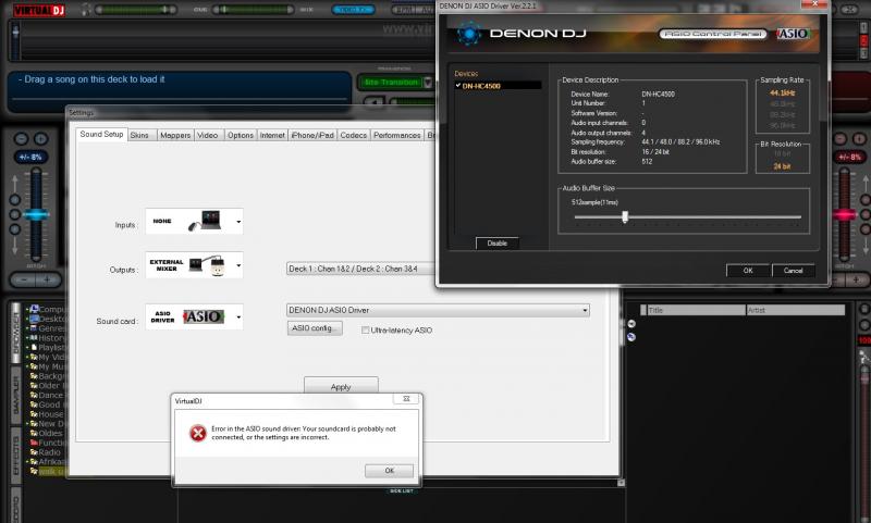

I am having the same problem. I have purchased a new laptop with Win 7 64bit and cant get my Denon DN HC4500 sound to work. Midi controls work fine. I have tried all the recomended drivers from the Virtual DJ forums and the Denondj forums. I have tried the asio 4 all driver. I have tried reinstalling Virtual DJ. The denon Asio driver finds my hardware fine. i get the error message when i choose Asio in the Setup. I have tried disabling all onboard sound devices. I have been using the controller for over 4 years and it is working fine on my old laptop. i am sure i know how to setup the audio as i have been using several different configurations. I need to get this working for my gigs this weekend. Any ideas?

The Denon Drivers are not working. I have also told the Denon guys. Here is a screen shot of the setup. All correct and still not working. Not sure if it is a Denon or a Virtual DJ problem

It's not correct. If it was all correct it would work!
You said it's a 64 bit OS.
Was the old computer (which you say worked fine) also 64 bit?
With a 64 bit OS you need to be 100% sure you're installing the 64 bit drivers.
Give us some details:
Is the OS up to date with service packs etc?
What firmware is on the Denon?
What version of the drivers?
What version of VDJ?
Etc.

Previous OS was 32bit. My laptop is fully up to date. if you read my previous post i have tried all the different versions of the asio drivers recommended by the Virtual DJ forum and the Denon website. I have tried uninstalling and restarting the laptop between installations, etc.
Firmware on Denon is the latest ie. 1006. Latest version of Virtual DJ (7.05).
I found it strange that the Denon website recomended different drivers to the VDJ forum so I tried them both.
Posted Fri 04 Nov 11 @ 1:28 am
After a 20min call to the Denon tech support and the guy on the line having never heard of the problem made me try several different things to isolate the problem. We uninstalled and reinstalled and set to factory defaults and stuff. That had no effect. Then he made me try something he said he had never tried before. We removed all the startup applications using the msconfig utility and restarted the machine, No more problem. We went and reinabled each of the programs in the startup to isolate the conflict and they all started up fine and the problem has not come back. I cant explain it and neither can he. but am happy that the problem was resolved and hope that this info can help others in need.

I am also receiving the same error & cannot isolate the problem. I am using Windows 7 64-bit Ultimate edition & I am trying to use the ASIO drivers for my Denon DN-X1700. I also disabled everything in startup under msconfig but still no luck. Any suggestions would be greatly appreciated as I am running out of ideas.
Posted Tue 06 Dec 11 @ 7:03 am
I finally figured out the issue. The Denon DN-X1700 frequecy cannot be adjusted while it is plugged into a laptop & the default is set to 96KHZ. As soon as I unplugged the USB cable, I was able to change this seting on the mixer. Plugged back the USB cable & the ASIO driver immediately recognized & sounded amazing.
Posted Wed 07 Dec 11 @ 9:06 am
