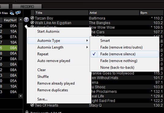

Read how to use Automix, you can play gapless and a few other metods in which VDJ can automatically mix your music.

I know all the automix mode, and no, VDJ doesn't play gaplessly.
It can automix (fade, beatmix, cut) but it's very different.
If you want to play back a mixed cd that you have ripped, you normally have to choose in automix the mode "None (back to back)".
So, the track have to be play without gap with the same mixes as the original CD.
Make a try and you will hear very little gaps between tracks.
And if you choose another automix mode, you don't keep the original mix.

Hi Huey,
I replied (in the other discussion) why i play mixed CDs.
And with automix (in "back to back" mode) you have little gaps between songs.
I know that in beatmix or fade, i don't have gaps, but i don't keep the original mix.
If a little tweaking can change that, i would like to know.

If you ripped the CD as individual tracks, VDJ will find and remove the silence at the beginning and end of each track with the secretly named feature "Fade (remove silence)" option:
If you some how ripped the whole CD as 1 big track, you can't expect VDJ to find and remove silence from the middle of a poorly ripped disc.
It works fine for me and everybody else.

@DHoude - its not about automix fade remove silence - (and I'm quite happy to accept that I'm not much of a DJ but I earn good money and give people a good party and have done so for 20 years - does that make me a good actor or just a charlatan)
@JoeyKJ - its not about cure points - the waveform files are fine - I have checked using waveform analysis.
It is the software that has a gap betwenn the end of one track and starting the next in either relay play or auto mix back to back. I'm just trying to find a way to play pre-recorded mix CDs as I use these for background/warm-up and occasionally 3 or 4 tracks together in a set. At present I can't so just trying to make it happen.

Hi all,
Thank's for all your reply,
DHoude, "remove silence" in automix move don't work perfectly. You always have very little gaps and it doesn't keep the original mix (make some try and i hope you can hear that).
PhamtomDJ, as said Derek, "relay_play" doesn't resolve the problem. You can automix in 1 or 2 decks; you still have this gaps.
Joey, why will we have to edit all gaps ? The gaps are not coming from the encoding, but in playback mode in VDJ.
That's why i create this discussion because I really hope that the next version of VDJ will improve it.
DHoude(2), I don't want to use Windows Media Player. I'm a VDJ User and it's only incredible that you can't make correctly with VDJ the playback of a ripped mixed CD.

Have you tried actually playing the CD through VDJ? Put the disc in your CD-ROM, locate it in the browser and drag the tracks to the playlist.
I would suggest using the back-to-back automix mode which is exactly what you want it to do.
If you still get gaps them we can look at whether it's a VDJ issue. If it plays fine, then it's the ripper adding dead space either at the start or end of the track.
I have a fair few Mastermix Grandmaster discs that I have ripped that play just fine with back-to-back.

thank you for your response.
I've just tried with MediaMonkey Free (but with latest lame), and still have this gaps (with VDJ, not in MediaMonkey).
Are you sure that you don't have little gaps when playing your Mastermix in "back to back mode" ?
