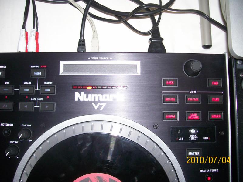

Deck A - note the connections and the Deck Select is on A with MASTER lit with LINK light ON

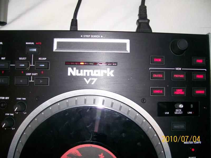

Deck B - note the Link cable and Power cable are the only thing connected, Deck Select is on B, MASTER is OFF with LINK light ON
