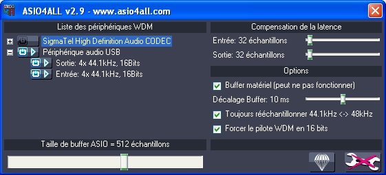

Hello Cioce,
You are right, it works in Windows XP with ASIO4ALL (I had disabled the crossfader in option menu, that is why I got only Deck A+Deck B).
Spin + VirtualDJ 6.1 Pro work
- this ASIO4ALL setting
- this Sound Setup
- this Mapper setting (VirtualDJ 6.1 Pro defaut map for Spin).
- this Sound Setup
Posted Mon 28 Jun 10 @ 11:48 am
