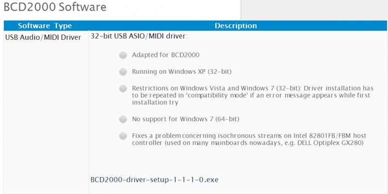

Justo to remember, there are restrictions with BCD-2000 drivers and Windows Vista and 7.
Maybe you are wrongly focusing mappers and VDJ Script issues.

- run BCD2000-driver-setup-1-1-1-0.exe in Windows XP SP2 compatibility mode and administrator mode (with right button option over the file .exe). Run it again after the first drive installation, for the second drive installation, if it would be necessary. Accept the security restrictions when the system alert you.
