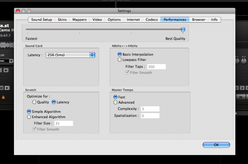

Can you take a screenshot of the performance panel in the virtualDJ config.

Posted Sun 21 Feb 10 @ 12:41 pm
Ok as I thought you have manually changed the settings after moving the performance slider so the slider position now ("best Quality") means nothing and that's why the sound is not good ;-)
Please let the slider sets the values for you and just select your own latency after that (I advise you "auto").
