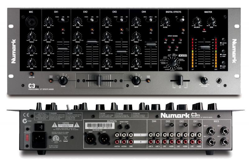

I use a Numark C3FX, 5 Mic inputs and digital effects.

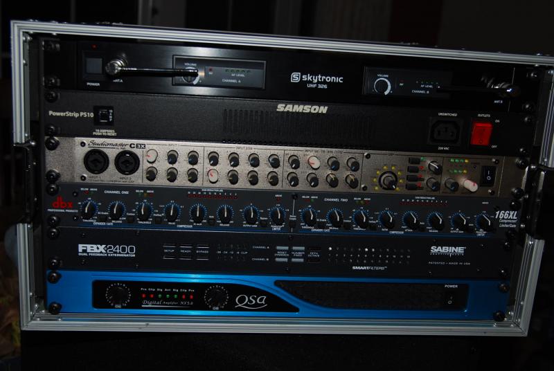

The silver 1u item in the middle, it's a rackmount mixer with four balanced mic inputs 2 on the front and 2 on the back. You can assign effects to each mic independently.
