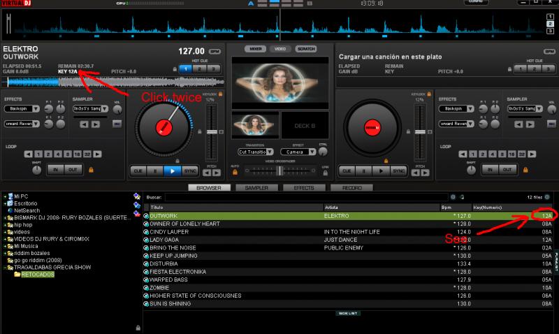

any body here to help me with the translation?
Posted Sat 18 Jul 09 @ 8:45 pm
Have you tried switching on the KEY column AND the KEY(NUMERIC) column (Camelot column) in the latest version 6.0.1 ????
According to VDJ and the Camelot wheel.......... 8A=Am............. 12A=C#m
Posted Sun 19 Jul 09 @ 4:55 am
Just click twice on the word KEY in the VDJ Skin...
Posted Sun 19 Jul 09 @ 2:14 pm
thanks thats exact what i am looking for
dj-agua
dj-agua
