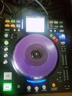

Been real busy and need to get a new video recorder. I did just put a vinyl 45 on the 5500 inplace of the clear disc. It\'s the 45 of Prince\'s Purple Rain - in Purple Vinyl of course! Works great.

Posted Thu 02 Apr 09 @ 3:05 am
