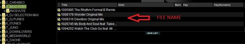

Virtualdj can read the id3 tags of the beat port files.this is an example:
1005985_The_Rhythm_Format_B_Remix.mp3------------->tipical file name of beat port
this is the file info:
(IMAGE 1)

remember that Virtualdj does not update the informations on his own database from the id3 tag automatically.
It's required forced by the user.
thera are this conditions:
1) The user has disabled the id3 read (picture 1), the datas are from the filename and store on the Virtualdj database.
If the user in a second time switch the software to read id3 tag , the previous datas loaded on the Virtualdj database are still the same(image 5).It's required to reload the tags (image 6)
