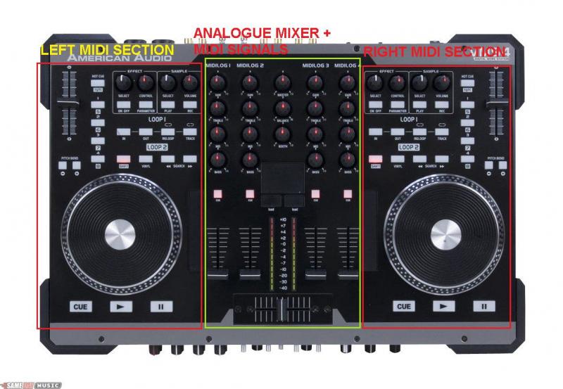

A few words about the VMS4
VMS4 is the first midi controller which has a 4 channel "analogue mixer.
The left and right sections of the VMS4 are pure midi. You can assign them as you wish.
The center part of the VMS4 is actually a pure analogue audio external mixer which also has the ability to send midi signals. It\\\\\\\'s not reccomended to assign virtualdj actions, only fake actions (such as fake_crossfader, fake volume,fake_eq etc). Fake actions move the sliders on the screen but they do not affect the sound of the VMS4. So practically you use the intergrated EQ of the VMS4, and not the EQ of the software. But you will be able to view the eq knobs to move on your screen.

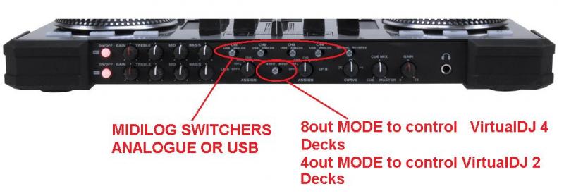

8out mode & 4 out mode
In order your VMS4 to contol the decks of the VirtualDJ software, you have to turn to USB the MIDILOG assign switchers.
- If you want to use all 4 channels of the VMS4 to control 4 decks in VDJ (4 decks skin) turn all of them to USB and set VMS4 to 8out mode using the switcher in front.
- If you want the 2 chanels in the middle (MIDILOG 2 & MIDILOG 3) to control 2 decks of the VirtualDJ software (2 decks skin) turn to USB just the 2 switchers in the middle, leaving the other 2 (CH1, CH4) to analogue. and set the VMS4 to 4out mode. In that case you can use CH1 and CH4 as analogue inputs, and you can plug 2 cd players.

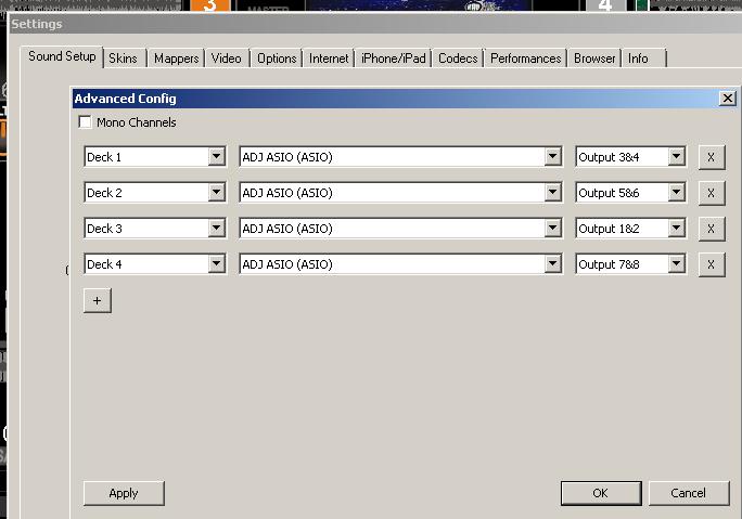

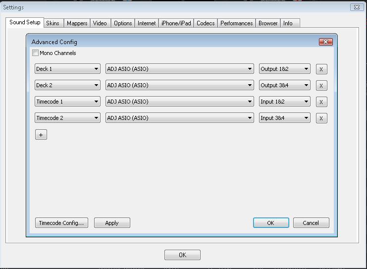

- Audio Setup (Advanced Config)
In case you want VMS4 to control 4 decks in VirtualDJ (with a 4 deck skin) set your Audio Config as followed
8out mode
In case you want VVMS4 to control just 2 decks in VirtualDJ (with a 2 deck skin) and leave the other 2 in analogue set your Audio Config as..
4 out mode

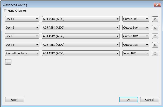

Recording with the VMS4
In order to record your mixes using the Record VirtualDJ feature you have to setup the Advanced Audio Config as followed.
This way your MIC is also recorded.

In order to run timecodes you have to turn your VMS4 to 4out mode. This way VMS4 turns to a 4X4 sound card meaning that you will be able to control just 2 VirtualDJ decks.
Plug your timecodes in to linein (midilog) 2 and 3 (the middle ones).Midilogs 1 and 4 can now operate only as analogue sources.
From the front side of the VMS4 turn CH2 and CH3 to USB
VDJ Sound setup

If you need to change from 8out to 4 out mode or vice versa before you do this, you have to power off the VMS4. Then make your selection and power the unit back on.

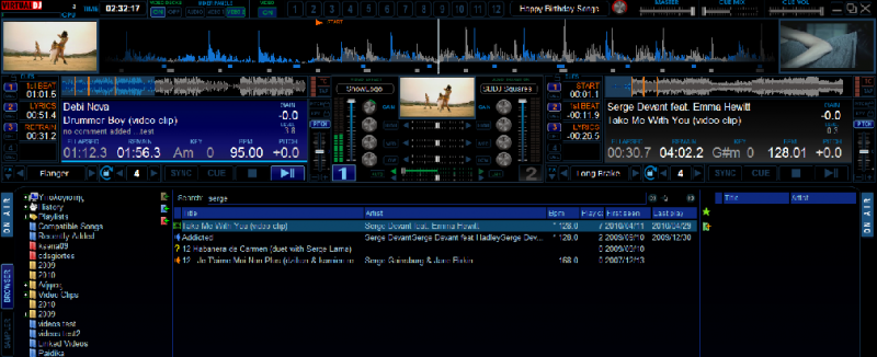

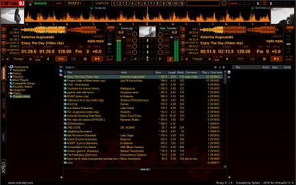

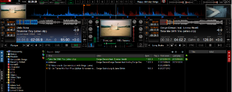

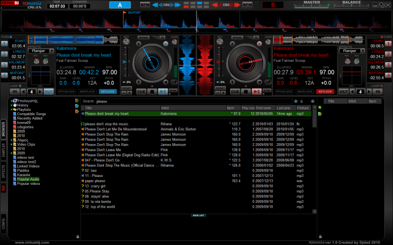

One of my latest creations for VirtualDJ ver 6.08
All the basic funtions are here, little sqeezed to leave a large browser.
Description:
Really convinient if you use controller and mixer, so all you need is actually the informations.
Available resolutions 1280X800 & 1440X900.
2 different colours (orange & blue)
Update Ver 2.0
1. Added Deck Frames selectors
2. 3 different colors for textzones. Choose what you like.
3. New icons for browser

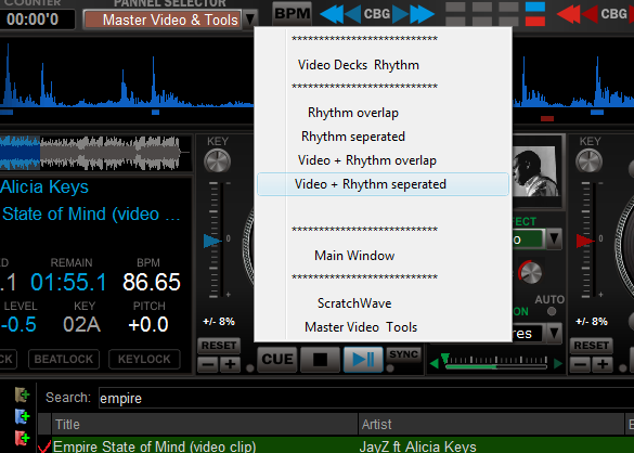

4. Added Video pannels for decks and 3 mixer pannels Suitable for audio and video mixing now.
5. Few color corrections
6. Minor bug fixed
Update ver 3.0
1. Dark color version added
2. New resolutions added (1280x1024 & 1366x768)
3. TC Quality indicator added
4. New highlighted Deck Selectors
5. New aluminium round faders for EQ, vol, gain etc
6. Fx and Loops now blink to view better
7. Graphic bugs fixed
8. Some minor corrections
orange version 2.0
Rusty dark ver 3.0
Rusty blue ver 3.0
Download link http://www.virtualdj.com/addons/11133/Rusty.html
For more informations visit the Rusty topic
http://www.virtualdj.com/forums/126467/Virtual_DJ_Skins/New_skin_in_progress_Rusty_V_3_0_(Ready_for_download_now).html
Enjoy !

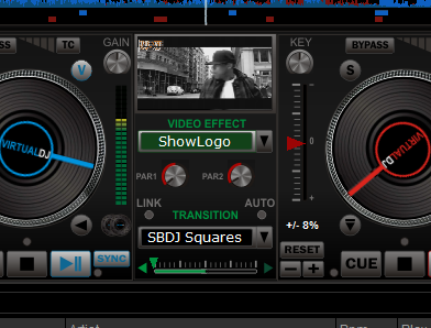

Mon 03 Aug 09 @ 3:30 pm
A very "simple" skin based on a large browser (that is what we need). Compartible with VDJ ver 6.0.1 at 1400X900 & 1280X800.
Available here .. http://www.virtualdj.com/addons/8815/Acropolis-V.html
You may see the Parthenon (Acropolis) as browser background. It's a symbol for us, the Greek people, and we give our fight so that several marbles of Parthenon may return home, where they belong. The British museum claimed that there was no proper place (museum) in Athens so they keep them safe and well kept. But since May of 2009 Athens has proudly built a brand new Acropolis Museum fully organized and modern with all the facilities, so we are able now to receive what it's our culture belonging. It's not an ethnic voice. It's a culture right.
**Tips for the skin***
a.There is a double pannel (Pitch-Key) pressing those 2 buttons.
b. Press V for video pannels (3 of them) and A for audio pannels.
c. Right click on the cues to set cues.
d. There is a EQ crossfader section, which you don't usually see neither on skins nor on audio mixers of the market anymore.
e. Balance for decks 1 and 2 are not working because VDJ does not support those actions.
f. Click on the textzones (title, remain, pitch, bpm etc) to change colours.
Soon an update with some missing spots (rec sample, loop sample etc).
Thanks for reading.

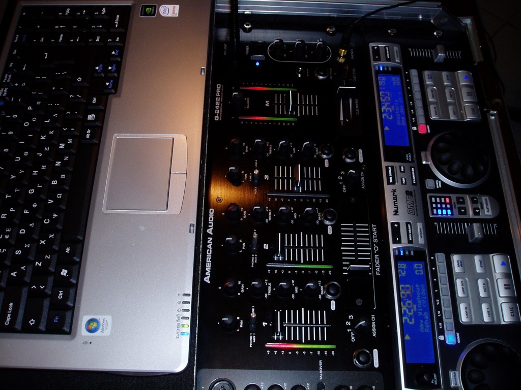

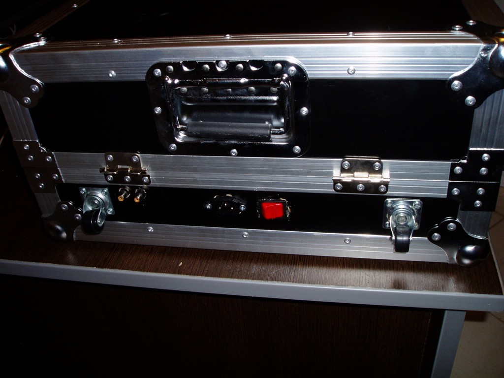

Fri 28 Jul 06 @ 6:03 pm

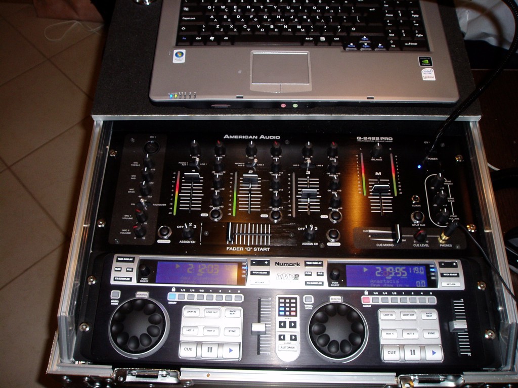

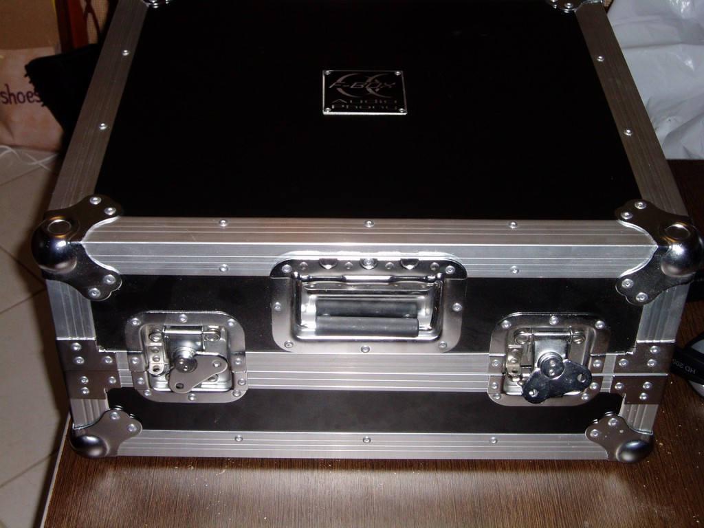

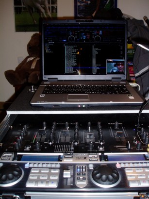

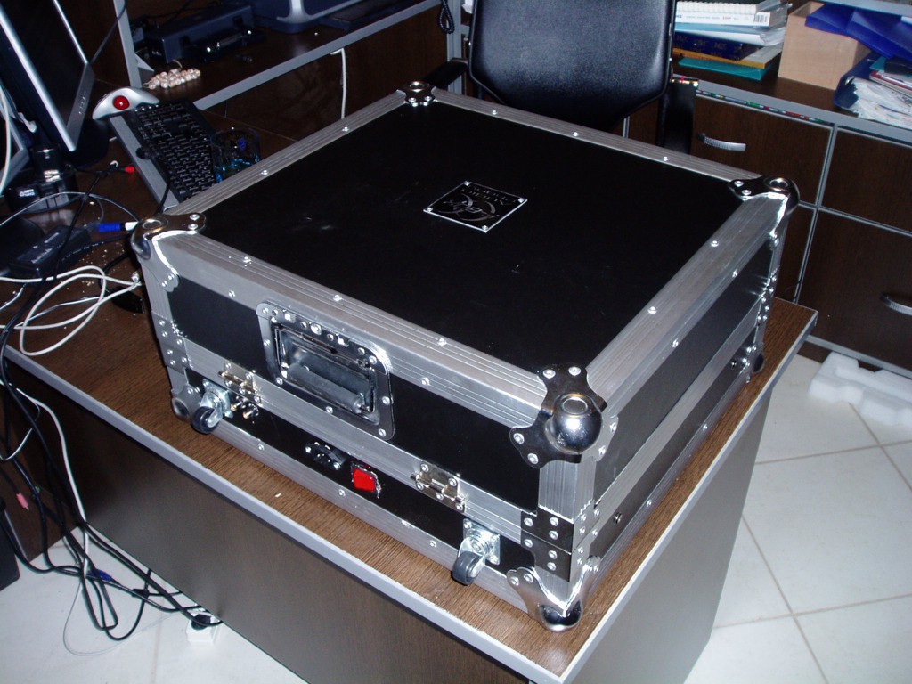

My new case ...
Laptop ..
TurboX 17" Maestro
Intel DualCore 2,2 Ghz
2 Gb RAM DDR3
HD 200Gb SATA
Nvidia 8600M GS 256 MB
HD External USB WD 500 Gb
Sound Card Maya44 USB
Controller Numark DMC2
Mixer American Audio Q-2422 Pro
Mobile case 19"
..and of course VirtualDJ Ver 5.07
They all run smoothly
some photos ..
