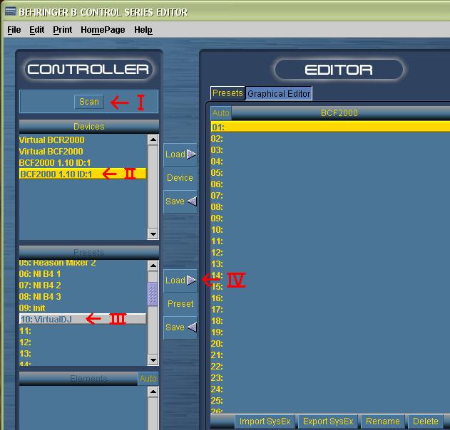

How to attach a specified plug-in or cross fader behavior to a button on the Behringer BCF2000 BCR2000.
First of all you need the B-Control_edit software link 1 link 2(zip) and Java 2 Runtime Environment, SE v1.4.2_05 or older (it will not work with a more recent version)
After you install and open the software;
Press the Scan button (I) -> select your device (II) -> choose a preset to modify (III) or make a new by pressing the Rename button in the Editor window -> to modify a preset; load it into the Editor by pressing the Load button (IV)

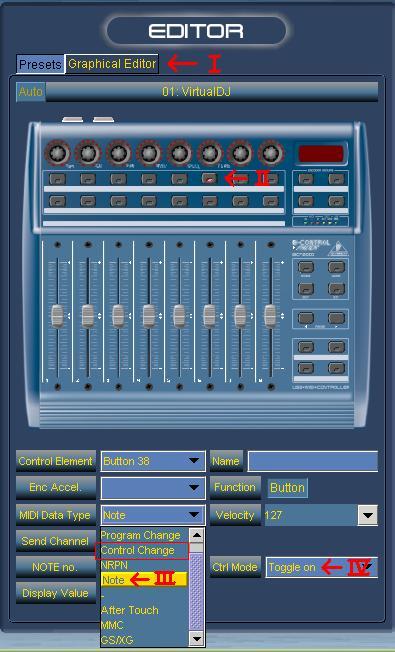

Once the preset is in the Editor select Graphical Editor view (I) -> select a button for the specified plug-in (II) -> then change the MIDI Data Type from Control Change to Note (III)
-> Remember to set Ctrl Mode to Toggle On (IV) or else the button won’t switch properly On/Off
-> Press Enter/Return before selecting a new button or graphic view

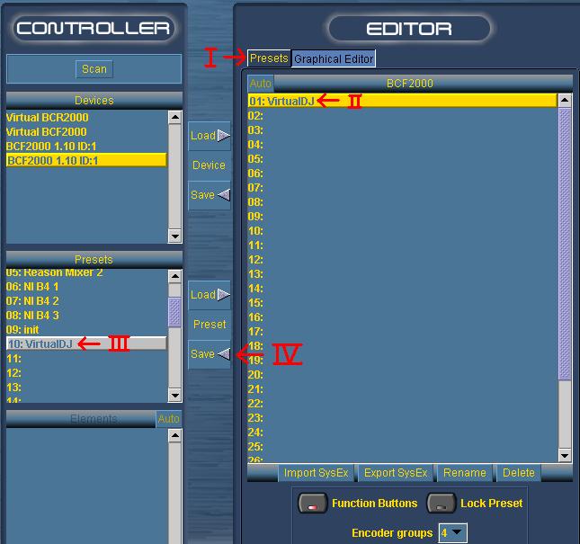

Then reselect Presets view in the Editor (I) -> select the preset just modified (II) -> choose a location in the Controller>Presets window to store the preset (III) -> press Save button to save the preset on the controller

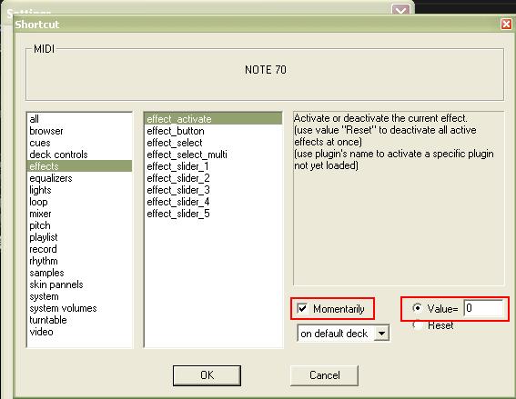

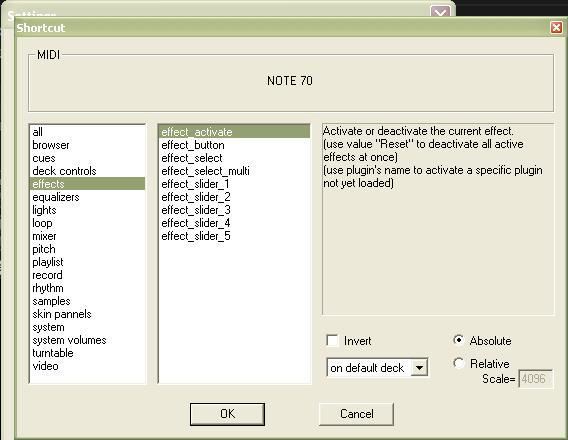

And the MIDI Shortcut window in Virtual DJ will change from;
This:
To this:
You can now write the value number of the cross fader behavior or the name of the specified plug-in in the value box. Remember to mark the Momentarily box for the button to work correctly.
