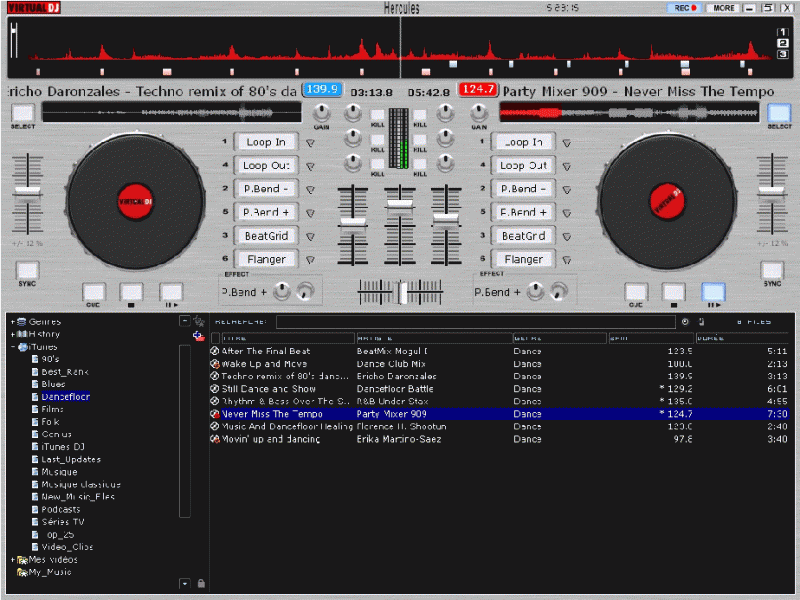

4. Load on deck B (right) the music track you want to play, and place the cross-fader in central position between deck A and deck B.
5. Push down on “Source 1” button on DJ Console Rmx, and release the button, which becomes blue.
6. If you talk in the microphone, you hear your voice in the mix. You don’t need to push on DJ Console Rmx Mic On/Off button.
7. Talk or sing in your microphone. You can adjust the microphone settings with:
- DJ Console Rmx Mic Volume and Gain buttons to set the microphone level,
- DJ Console Rmx left deck Bass, Medium and Treble button to set the microphone equalisation.
8. Click on VirtualDJ REC button, type the name of the music you will record, and click on Save to start recording. The REC button has a red dot during the recording session.
9. Click again on VirtualDJ REC button to finish the recording. The REC button loses its red dot when the recording is finished.
10. Push on Source 1 button again to switch off the external source on left deck, and to recover the computer audio as source for the left deck.
=> You have recorded the mix of your music on right deck with your voice on the microphone on the left deck.
