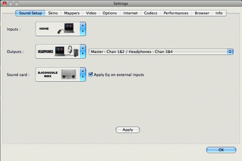

Switch in ASIO mode in going to VirtualDJ Config menu, to the ‘Sound Setup’ tab and check the setting ‘Apply EQ on external inputs’, then click on ‘Apply’ and ‘OK’.
You can check you are in ASIO in DJ Console Rmx control panel.

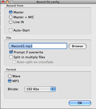

In VirtualDJ, go to the Record menu, click on the config button in the record menu and choose choisissez ‘Record from Master’.
Click on ‘Start Recording’ to record.

Go to VirtualDJ Config menu, on ‘Sound Setup’ tab and check the setting ‘Apply EQ on external inputs’, click on ‘Apply’ and then click on ‘OK’.

Go in VirtualDJ Record menu, click on the ‘Config’ button of this Recod menu Record, and choose ‘Record from ‘Master’.
Don't change the recording folder from the default MacIntosh HD. Click on OK.
Then click on ‘Start Recording’ to record.
