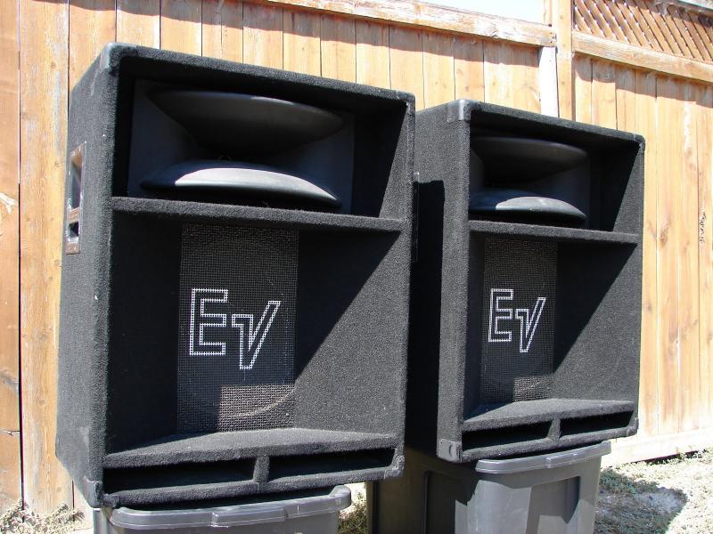

Horn Loaded Cabinet
A horn loaded cabinet like this is mainly a mid/high cabinet but there are sub woofers built with this design. (co-axial horn Subwoofer) They have the advantage of Longer throw and usually better frequency response. Because of the woodwork involved they are more expensive than other speakers of similar size.

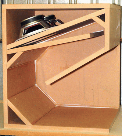

Folded Horn Subwoofer
These are the Monsters of Subwoofers. They offer incredible sound quality and throw. Often using much smaller speaker sizes than with sealed/vented cabinets. Most often used in concert sized P.A. (now called line arrays)
