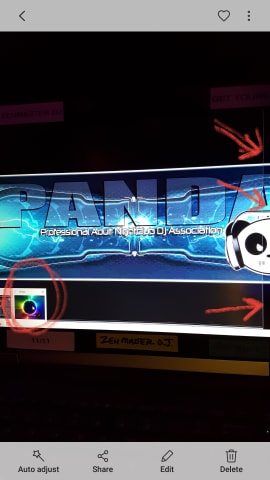

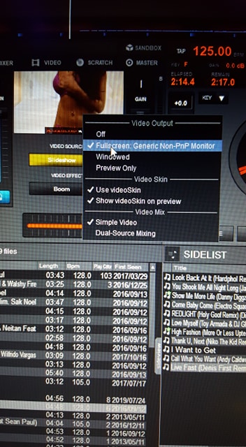

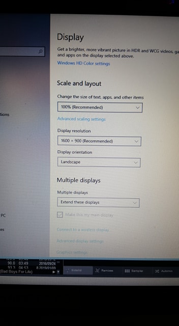

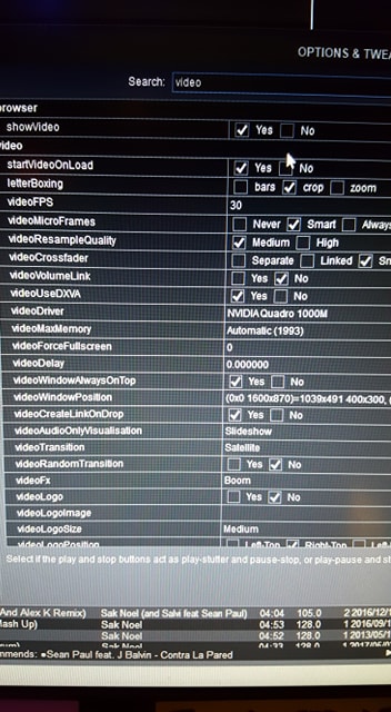

Nicotux. I'm ALMOST there! Lol. When I right click on the preview menu it shows generic monitor, not my separate video card driver like you suggested. Even though it's selected in my video settings. I took a picture of both. Maybe I'm missing a setting. I hate to ask for more help. But I'd greatly appreciate it.

NicotuxHome userMember since 2014
Yes, but everything looks OK
VDJ used to display driver name for every output, it now displays name of connected Monitor instead and only the one(s) without the main VDJ Window
It look like windows was not able to read EDID from external TV, that does not hurt in any way but the name

Adion. Thank you for your reply. I understand what it is supposed to do. But it isn't getting there. All the settings appear to be correct. As you can see by the one picture with the arrows pointing to the line, that is where the video box is. I can't grab it to move it over to the next display (or the lengthened monitor space) When I try to grab it, it disappears. I can't double click on it. Nothing. As you can see from the pictures above, it just says generic pnp monitor. I don't know if that makes a difference. But I have a seperate video card and I don't know if it isn't being utilized. Im stumped Thank you again

What if you click he generic pnp monitor again from the drop down?

with your screenshot, IMHO your VDJ video window stays somewhere the external display was located in a previous start
i.e.: on screen 2 in [1][2] configwith screen 1 @ 0x0 and windows detect now [2][1] keeping [1] at 0x0. Hallas for me this is a common issue not only with VDJ
Make sure your displays are well allign in windows display parameters [1][2] and try the opposite if possible or changing "main display" if possible too
otherwhise, if it's the VDJ video window the arrows are pointing to then the mouse should allow to resize enough to be able to move the window ...if line is far enough from border
if too small main window action will take precedence making it disapear. try to set setting videoWindowsAlwaysOnTop to "Yes"
try to window main VDJ window in a way for it not to stay under the video window making it independent
A minimum width is needed to be able to move the window in a way to make some space for the resize zone, a minimum size is needed for the mouse detect the move zone
but sometimes with "deadzone" or "overlapping" some drivers are drawing some artefacts like that or do not allow mouse to exit the desktop
Temporary "clone" displays instead of "extend" the time to get the window on the main display, save VDJ settings and reverse to "extended" may help
