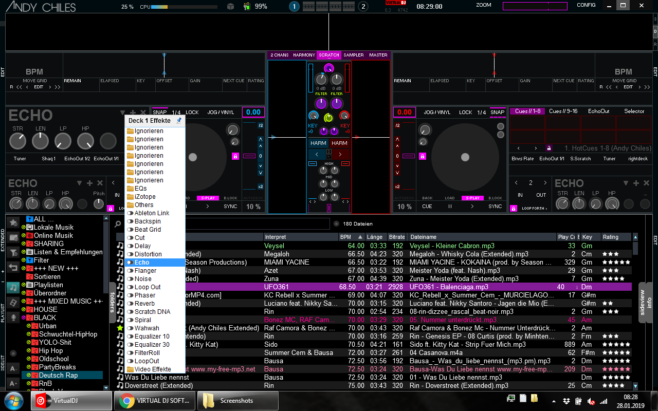

Sure, it looks like this:
In fact this already looks like this since a long time.
Maybe half a year or more.
And in this "ignore-folders" at the top of the list there are also some filter-effects.
But I never moved effects into my ignore-folder on my physical drive and there are still no effects in it.
Posted Mon 28 Jan 19 @ 7:35 am
So I never did this before, but I tried rightclicking the effects in the ingored folders and so it worked to get the Filter back to its place.
Buuuuuuuut I still can't figure out the reason why they were in this folders.
However...
My problem is solved now. ¯\_(ツ)_/¯
However...
