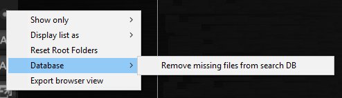

The Magic.DJ wrote :
don't forget to clean/fix your DB.
hello there. How do I get to that option with VD8 ? I have a ton of missing files, they just keep showing up.
Posted Tue 06 Nov 18 @ 1:58 pm
if you look in the bottom left of the browser (just above the font size symbols 'A' you will see a 'button' for browser options click this and the window shown in your image will come up - hope that helps
Posted Tue 06 Nov 18 @ 4:03 pm
Thank you so much! You have no idea how long I've been looking for that. Why did they hide it so much? It should be right next to the search box. Anyways. Thanks again.
