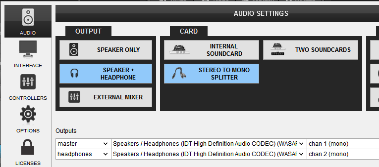

Also, I have bought a DJ splitter cable and can anyone tell me how I change setting to have one side for headphones and one side for the speaker system I will be using on the day?

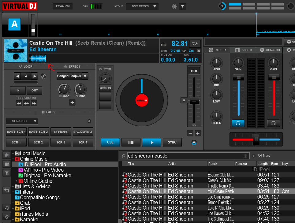

I use iDJPool in Denmark without any issues, so I would think so yes
And yes you can download to cache and use the tracks offline
BUT
iDJPool is a DJ pool licensed for DJing in public - but it doesn't have everything like Spotify does
You can test it's content for free without signing up, simply by starting using it
It will work fine without the subscription - but you only get 30 sec of each track
Like this:

The splitter cable has it's own setup button in VDJ so that's easy to setup:
Open the config, and click on the big button saying "Speaker + Headphones" and the button next saying "Stereo to mono splitter", and you're good to go.

Hi,
Just wondered as I am testing it tonight. With the setting on this thread with the internal soundcard - Should this be fine to use at the party into a PA and still hear what I need to in my headphones without the crowd hearing it?
Cheers
Cheers

I suggest you test things with your splitter cable. Use as much of the equipment you'll be using the night of the party as you possibly can. If the PA isn't available ahead of time, use a home stereo or something else. The pros take the time and effort to eliminate chance events as much as possible, and you can too. (Edit: I just noticed you said you are testing tonight - great!)
Read the manual. Experiment. Try things out for yourselves. If you get it working well, there's no need for a USB soundcard (or a controller) at this point.
The nice thing about these forums is they can give you an answer to a question (and you've got lots of answers to your questions), but they can't replace the experience you'll get by trying things yourself, and figuring them out.
You'll also learn a lot if you research things yourself. Read these forums - many questions have already been answered. Read the manual. Go to manufacturer's websites and look at the products. Go to a store and try them. Talk to the salespeople in the stores. Somebody here can tell you they love their XYZ product but it may not be ideal for you in your situation.
So: try what you've got, get it working, and then decide if that's enough to do what you want. If not, do some research to see what else might work.
Good luck!

Phil. Thanks so much. I tested it all with a home speaker and all good. I am a little worried what it will be like in the night with big speakers and PA but you post really mad me realize s good few things. Really appreciate that
